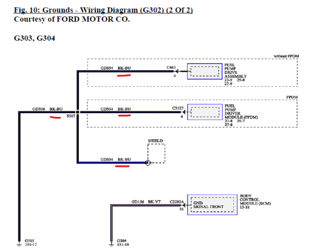

Next would be fuel pump ground? The pump is under the back seat. Follow the wires and do the same.
Just so i'm clear, you're saying to clean the contacts for the wires on top of the fuel pump, or somewhere else near the fuel pump? Am I following the wire from the fuel pump or to the fuel pump.
I would identify the ground at the pump and clean its origin at the body.

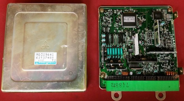

Photo of a PCM with the cover removed:
