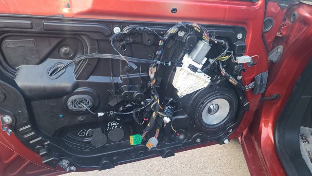

rainbow 2 way component set
cdt audio es-03 midrange in a speaker pod with the tweeter from the rainbow set

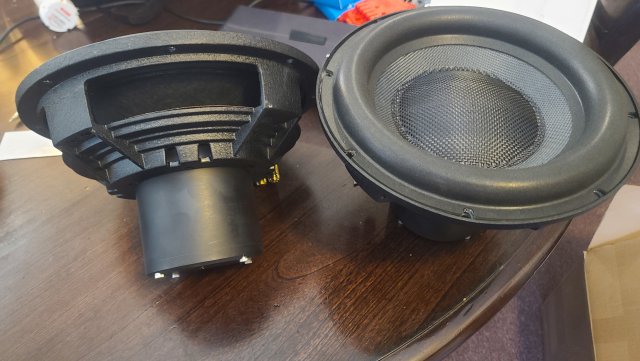

10" custom SQ sub 600 rms watts and a 1.12 cu ft sealed box.

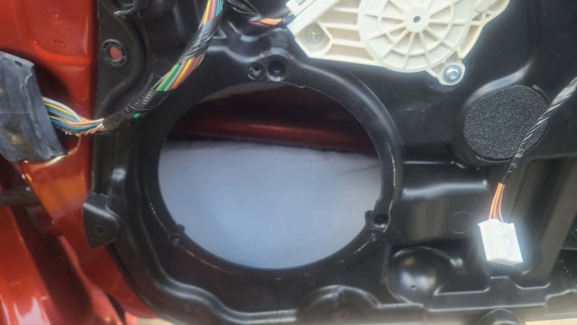

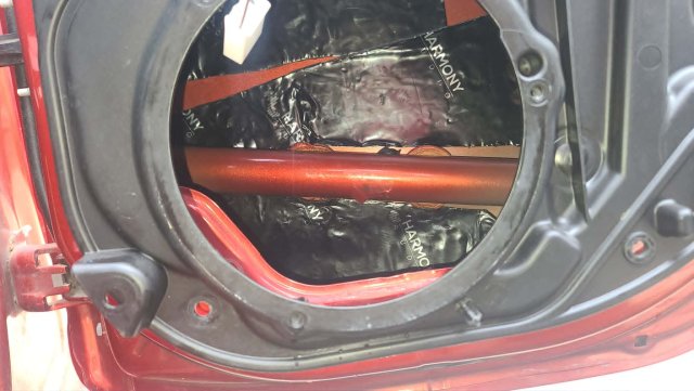

the doors all have 70mil harmony cld in them as well as 1" melamine foam (hydrophobic)

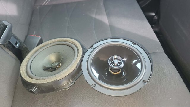

rears have the same cld treatment and foam, as well as the coaxials already installed.
the mids and tweeter will need new wires run under the dash to the dsp.
