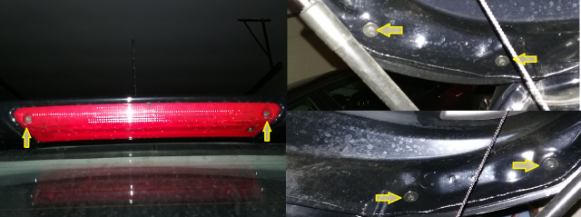

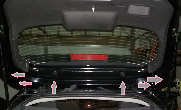

I found that the rear hatch window leaks water when it really rains hard. Just a small amount but I want to nip this leak in the bud. I've already got one rusty car and don't need another.
That said, does anyone know how to gain access to the upper edge of the hatch glass? I want to re-seal it with some window sealing caulk (for cars, not houses) before it gets really wet here with our summer torrential rains.

There are videos in YT about the Fiesta - you will have to remove the rear spoiler - it is a simple cover and uses Torx head screws and Hex-head bolts.
The rear spoiler has at least 4 Torx head screws and several plastic push clips to fix the cover. There are two main bolts to hold the spoiler - are ones in the hatch, that use hole plugs to cover them and just open the hatch and their covers are right there...in front above the seal and between the hinges.
You also have to remove the 3rd rear brake light and watch out for the hose from the "squirt squirt" washer line to the front for your rear wiper. That one-piece assembly uses two torx screws.
