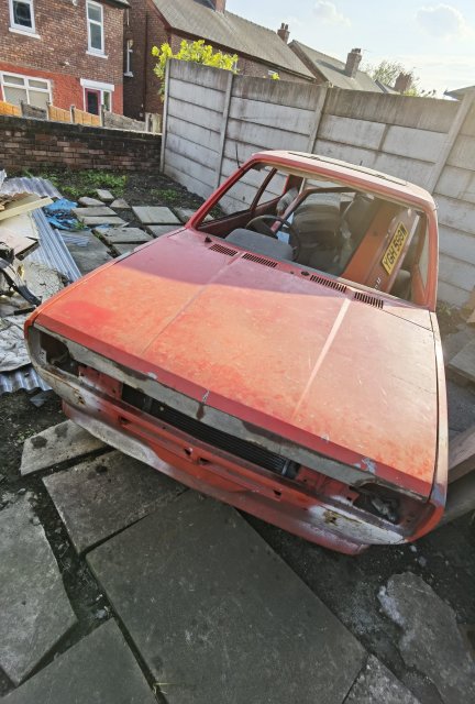

Hiya all,
Im Jaan and I recently purchased a 1982 fiesta 1.1 popular plus.
I'm excited to get my car ready for driving lol.
I have some questions regarding running gear and wondered whether to post it in informal discussions or the technical forum...
