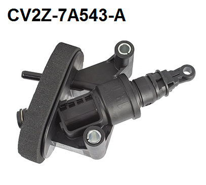

IF you have time, get under the dashboard, look at the Clutch Pedal - follow that arm up into and under that dash.
There are a series of levers - and what looks like switches on them.
The arm of the pedal has a switch, and the switch rests on a bumper stop - that pushes the plunger of the switch in or out. So, if the plunger, or the bumper stop - has something in its path - it can affect the pedal operation.
The Clutch pedal - has or uses a "stopper" and bumper stop - so it doesn't make a lot of noise or transfer noise into the dashboard from the engine running on the other side. It also works a plunger towards the front firewall - that goes into a "Hole" - this is the Clutch "master" - this is where the Brake Fluid from the Reservoir flows into and from - when you press on that pedal - that plunger works the piston on that little machine.
There are several things that can go wrong - including a Bad Clutch Master Cylinder (you have to specify this) the photo above is for a 2012-2016 Ford Fiesta model
Below is the SAME Car but from 2017 thru current...
So, your configuration may vary but the principle is the same.
Fluid enters in thru a smaller upper tube - has a small "ball" in it - so that when you press on the Pedal - the larger Plunger lever pushes fluid, that small ball - lifts up out of it's seat and stops fluid from going back up that small tube - and forces the Fluid thru that larger outlet towards the Slave.
Now, from what I've gather from experience - the ball in the "ball seat" for the upper hose that comes from the Brake reservoir can dislodge and get filled with dirt - preventing pressure from building - and so the piston moves but no fluid ever really makes it to the Slave Cylinder.
So, once you understand that concept - the Manual Mystic mystery disappears -
You can also have dirt and or a failed seal in the unit - which would cause a leak - so check for that at the firewall - fluid will push out where it's the easiest to go.
The Return spring that lifts the pedal from the down position to return it up - can break or "get sprung" when you push the pedal down, the thing won't return.
So got to investigate what they didn't finish the job on, including a broken hose, a fitting letting in air, or the system has not been bled properly and you'll have to have them finish the job.

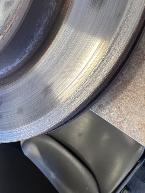

I've been a bad forum member - not returning and reporting.
Since this time, last October 2022, I wound up with something that landed me in the dealership, so I had them investigate it. I've grown to live with this issue, and on finding out the diagnosis I'll just keep the car till it's wheels literally fall off. Both fixes proposaed are worth more than the car, and I don't want to saddle someone else with this burden either (weird history of sold cars in the family weighs into this as well lol but that's for another time haha)
They found that there's one of 2 "fixes" for this issue with the Hill Start Assist.
1- Replace the PCM for $2500, as this fixed the singular previous case they'd seen of this, to correct the potential burnt out or poor signal to release the brakes given, but the signal to hold the brakes works as manufactured. They were able to reproduce this issue themselves at will this time.
2- Replace the whole top to bottom ABS system $2200-2500, the fallback option as if it isn't in the PCM computer, it's in the HSA portion of the ABS.
It affected the front drive side brake more than the passenger side, that is until I replaced the rotors, brakes, and caliper on that side this March 2023, and seems to have evened out the wear a little. Both sides still grab if I stop on a hill, so the perpetual rocking on the clutch is what we do. Car never gets loaned out due to this issue, so that's a plus 😂
