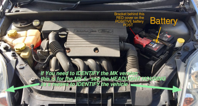

The Fiesta year this one is, is called by some as the MK6 version of the FIESTA - so again, the upgrades from previous years also included their Fuses and location of them...
Let alone how they looked...

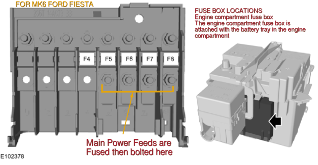

In the MK6 - the Fiesta had a MAIN Breakout box - or Engine Compartment Junction Box - which took the Battery power and broke it down into the wire feeds to various systems using a bracket/Fuse Mounting location at the battery.
Like this...
Engine junction box

FUSE                            Ampere rating            Circuits protected
                                  (Amps)
   F1                               N/A                           N/A
   F2                               N/A                           N/A
   F3                               N/A                           N/A
   F4                      40 Petrol / 50 Diesel           AC and Cooling Fan
   F5                               60A                    Lighting and GEM
   F6                               60A                    Ignition Relay
   F7                               60A                    Engine and Lights
   F8                               60A                    Anti-Lock Braking (ABS)

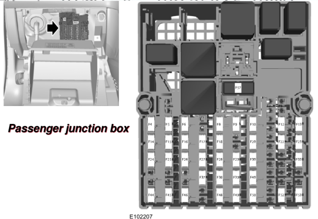

Then you have to look into finding the Glove Box, and remove it's contents and pull the Door down past it's pinch point stops (they pinch inwards - you'll find them on the sides of the box itself) and expose the Passenger Compartment Fuse Box...
(Might) - Look like this...
This is where the main power to all the smaller feeders goes, with the main power breaking out and fused in the Engine bay...

Code:
    FUSE                            Current (Ampere) Rating                Circuit Protected
Not used-F1                                ----                                     N/A
Not used-F2                                ----                                     N/A
Not used-F3                                ----                                     N/A
     F4                                      10A                             Air conditioning clutch
     F5                                      20A                             ABS Valve
     F6                                      30A                             ABS Pump
Not used-F7                                ----                                     N/A
     F8                                       3A                              Powered rear view mirror
     F9                                     10A (Left)                       Head lamp Low (Dipped) Beam - LHS
    F10                                     10A (Right)                      Head lamp Low (Dipped) Beam - RHS
Not Used-F11                             ----                                      N/A
    F12                                     15A                               Powertrain Control Module
    F13                                     20A                               Heated Oxygen Sensor/Powertrain Control
                                                                                                Module - Diesel
    F14                                     30A                                Starter motor relay power
    F15                                     20A                                Fuel pump
    F16                                      3A                                 Powertrain control module power
    F17                                     15A                                Lighting switch
    F18                                     15A                                Onboard diagnostics/Radio (DTC)
Continues... This is done up to preserve formatting of the pages it's listed in the Owners manual
