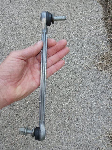

Original equipment type; Non adjustable and not grease-able. These parts have been revised five times! It is definitely a part that was less than stellar from early on. If your Fiesta makes it past 30,000 miles and one of these hasn't failed, you probably should get a pair of new ones because the handling is very likely to be very mushy without even realizing it.
They retail for about $35 each. I won't call them shit. But, you can do much better for less cost.

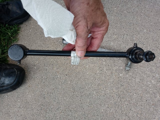

Moog # K80104 (this part number might have changed) ; steel construction, much more robust ball and socket ends. Grease-able joints. These are the gold standard of rough service parts! Thank you , Moog engineers and product planners!
These retail for around $25 each.

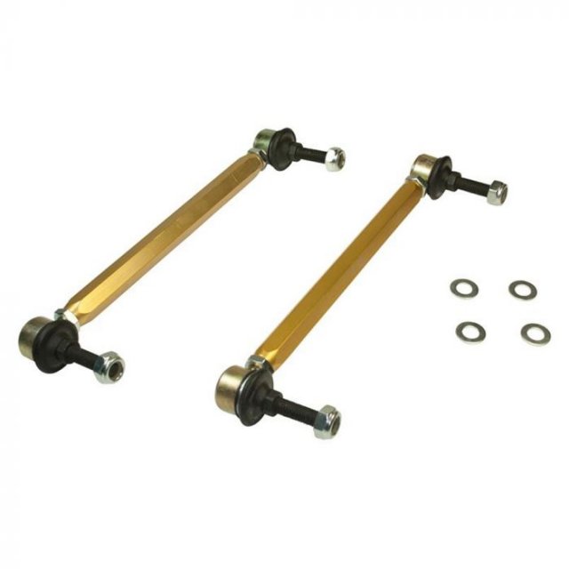

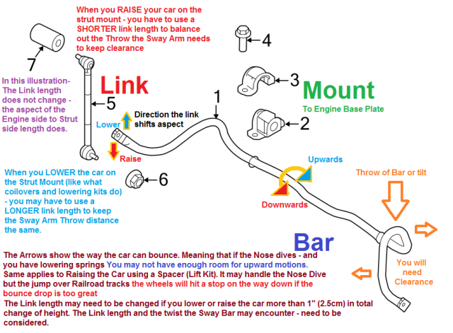

Whiteline adjustable end links #KLC-140-255; You are now stepping into the boutique world of suspension tuning parts!
These are very good quality parts. They are fairly lightweight yet durable. They are not grease-able.
Being adjustable, you must take some time to play with the length adjustment to get the handling feel that works for you.
Prices are going to vary greatly. $160 list to about $95 a pair. Only sold in pairs. www.sales@whiteline.com.

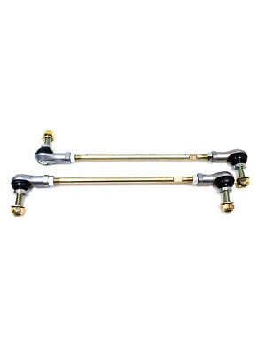

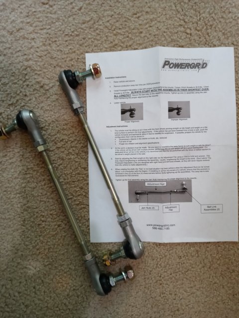

Powergrid adjustable end links; this one is a few dollars more than the whiteline links. But they have a couple of significant differences. First one is a patented design and material spec that offers greater degree of articulation and secondly a very innovative spherical joint that is sealed and self lubricating and non binding. If a person can get excited about a suspension component, an argument could be made for this one. These are around $175 a pair, and worth every single penny. These parts are so robust that i don't think that they will ever " wear out" on a light car like our Fiesta's. contact Chip at www.powergridinc.com for an application.
