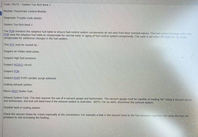

I’ve attached an image from Forscan DTC.
My suspicions now are to do with Fuel system, either injectors, rail or fuel pressure regulator?

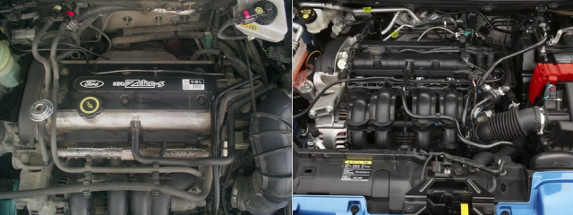

Hmm...The One On the Right - looks Like @scotman has been here...? [driving]
