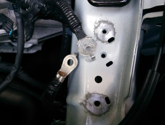

The main "ground" for those fans is at the frame member just below the battery - and considering it is an '06 - those lugs may have corroded.
You should be able to find the wiring harness route to them.
