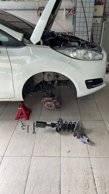

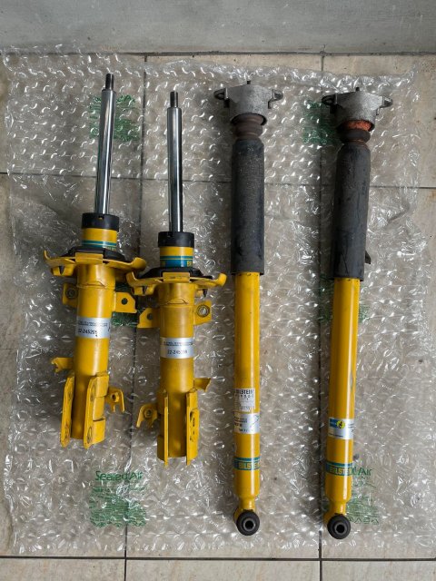

Hello every one. It is my first attempt on a forum. I am Taiwanees, please forgive me bad english skill.
i'm wondering to know what coil spring will you suggest for bilstein B6? the FRPP spring will fit the B6 and work well?
here is my situaction
My car is Fiesta hatchback(CB1/CCN) 1.0t with automatic transmisson(south pacific asia version). This version use the same front Shock and Coil spring with Mazda 2, not Eour or Us version Shocks.
I bought the brand new Bilstein B6 Shocks (22-245199+22-245205+24-239318) for upgarte my suspension, but the Front OEM spring of my car is not fit for this B6, so i bought the Fiesta 1.4 automatic OEM spring(part no: 1547179(F)+1523225(R) for insteall.
After finish install, i go test drive, the car feel very stiff and bouncing, uncomfortable. After 4000km drive, i decide buy the FRPP handling pack (M-FR3-FA) to change out the B6. But FRPP is too soft for me....the handling of Frpp Kit is terrible, i want Change back B6, so i want to know any suggestion spring for B6?
best regard

Hello Lorenzo. Is the problem in the front struts only? Does it ride hard primarily at the front? Please post up a couple of images of your dampers on the car.
B6 is a firm riding damper. The piston is larger than any of the other struts we have found.
The FRPP kit is the base European spec for mk7 and 7.5 fiesta. And you are right, it is on the softer side of the scale of ride quality.
What is your intended plan with this? Are you just wanting to renew the suspension? Or are you wanting a firmer, more controlled ride? Or are you wanting to lower the ride height?

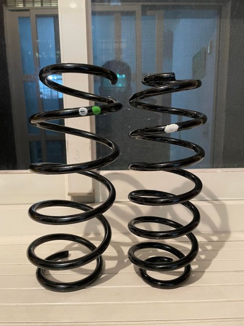

Hello Scotsman, Thanks for getting back to me. Fiesta 1.4(at) oem spring combo B6, make stiff feel problem happening in both Front and rear, especially rear shock. Some times,when speed go 80km up, i feel my car were bouncing back and forth.
As a daliy driver, due to bad road quality in Taipei city of Taiwan, i don't want make my shocks too stiff or harsh; but also want improve more controlled ride than oem shocks. So i plan my car can get the blance in ride comfor quality and handling, the ride height can keep or dont lowering too much(1 inch maxima).
I have tried changing the B6 to a FRPP kit, but FRPP is too soft for me
Is it possible to use the FRPP spring go with B6? the Front FRPP spring(Left green white dot) and Rear FRPP spring(white dot)

Ok. I am understanding more clearly now. The FRPP springs should be ok to use. They are not a heavy duty or performance type of spring. Your problem with spring and strut/shock choices is exactly why we have begun these brand specific threads. Everyone is trying to get a good choice for their fiesta. If i were you, i would adjust tire pressures closer to the label on the door jamb. The tire max psi statement on the sidewall is probably several bar greater than the door jamb decal. Try lower tire pressures in rear first. Fiesta is not very heavy in the rear. Small tire pressure adjustment can make noticeable ride quality improvement!

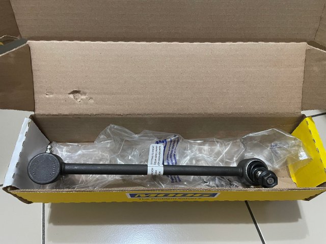

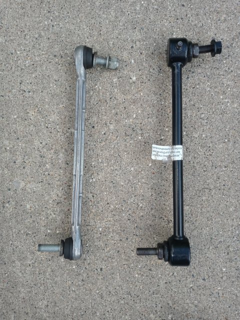

In front, i would be looking at the tire pressures and then also inspect the anti sway bar end links and the frame bushings on the subframe. Those endlinks are not the best thing for long life on rough roads. Those are very good images you posted! Please keep us updated here!
The silver end link below is the Ford original part. Not so great in rough road conditions. Black one next to it is a replacement part from Moog that is much stronger and is Grease-able as well! I think that those Moog parts are offered in Pacific rim markets too. Not sure. 20220706_191829.jpg

I've tried adjusting the tire pressure and also already upgrade STABILIZER LINK ,Great minds think alike ,i chose MOOG , higghest CP product of aftermarket part.
i got those from ROCKAUTO.

The Moog links are a real bargain!

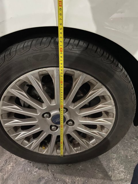

I have a 2011 SES with 146,000 miles on it. Bought it last year. The drivers side strut is shot and the suspension rattles around. It looks like the front struts are OEM (shocked that they're still on the car, no pun intended). The rears have been changed and are Sachs, so el cheapos. I've decided to replace them all with the B6s, and I'm curious how your setup turned out.
It looks like the coil springs are fine visually, but they could be shot. The drivers side sits a little lower than the passenger side (1/2") under the top of the fender, but that's probably due to the blown out strut, right? But who knows. I'd like to replace the springs while I'm doing the work, but the only ones I can find for a 2011 SES (non-ST) are the typical hard core lowering springs, which I don't think I want. Since this model is relatively constant up to 2016, I'm wondering if I could get the OEM style springs for a 2014 ST and use them to get the slight lowering effect. The tires are 195/50-16's, so they're only 0.22" taller than the 17s that came on the ST.
