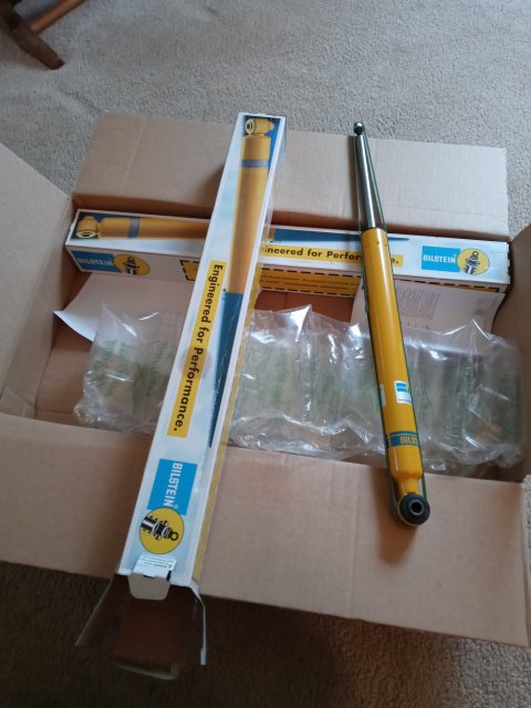

Everyone here who chooses the B6 Bilstein shocks and struts should feel free to post up an impression of the components and discuss your choice of spring sets! This way we can help each other take the guesswork out of what certain choices might result in.

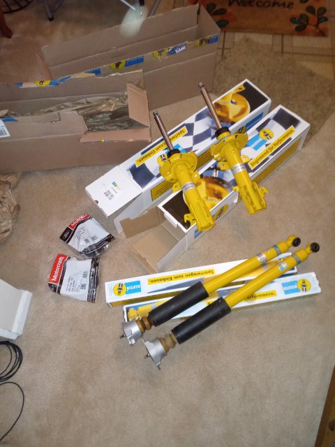

Expect delivery of the B6 struts and shocks by Saturday. Not sure which pair of them will show up first because they are coming in from two separate locations. I am trying to chase down the last couple of bits to get it all done quickly.
The rear shocks were dropped off at my door this afternoon. I decided to compare these Bilstein to the rear STR.T shocks for firmness effort to compress and the speed of rebound. I will try to do a video as well. The B6 is easily twice as hard to compress as the STR.T! And, the b6 rebounds a full 4 seconds quicker from full compression than the Koni. Too bad the cars these are going on are so different. It would be interesting to run these dampers against each other with a G tech performance meter on board. 20210429_151054.jpg
The front struts arrived today. I also picked up the strut bearings. Just waiting for the strut boots and spring insulators now. The rear shocks are assembled and ready to go on the car. 20210503_193735.jpg

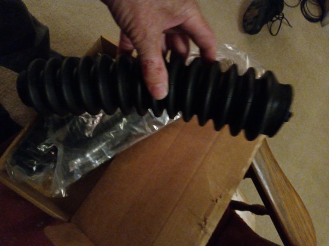

Strut boots came in. The O.E. are not available at this time. So i sourced a pair of strut boots from Autoanything.com They are Tough.Country #69127 and cost a little under 20 bucks for a pair, minus the shipping. They appear to be well made and are more than long enough to protect the strut piston and were easy to snugly fit over the strut tube and secure with a zip tie. 20210506_212232.jpg 20210506_213233.jpg
So these don't "funnel out" to fit the upper strut mount?
I wondered about the bearing cup the strut boot and knowing it fits the bottom of the strut - what do you use for the top? That bumper stop?
I am going to figure that out tonight. This boot is more generous length wise than the O.E. part. It really doesn't need a barbed retainer to keep it located. The bellows will have more than adequate range of motion without stretching. Unlike the original part.
I just put a zip tie on the bottom of it. The large end fit snugly over the provided plastic clip at the top of the strut tube. They dont funnel out at the top. But, i dont think that is a big deal. So, far.

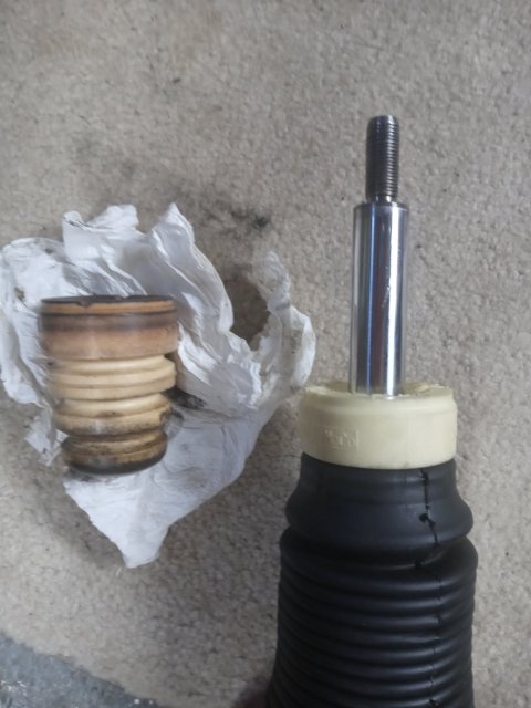

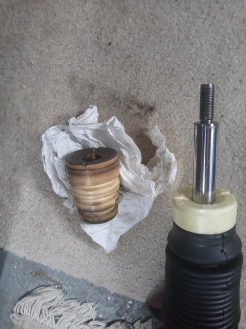

Well, as usual it's a mixed bag of joy and frustration. The upper bump stop is a little bigger diameter than the clear opening of the bellows.
The bellows is very flexible and can be worked onto the foam bump stop. I doubt that it would even 20210507_232856.jpg need a zip tie to hold that in place.
20210507_233332.jpg The bump stop moves on the piston with some resistance. So, anything that i use to make it go up and down the strut piston will have to grip the upper stop like the upper stop that is pressed into the rear shock mounting cup. That would give us a functional upper bump stop with a protective piston boot.
I am going to continue to work on it. Im still waiting for the front spring insulators.
Just out of curiosity, i compared the amount of resistance of a new upper bump stop to an original. No detectable difference between the new service parts and the 67k parts!

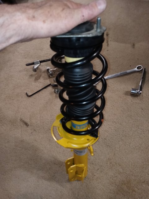

Both front struts are now assembled with the cobbled 3/8 rubber hose spring insulators. Not my first choice. But time waiting for bits and pieces is burned up! The jolly is getting the original spec coils. No lowering coils for this one! 20210518_115302.jpg

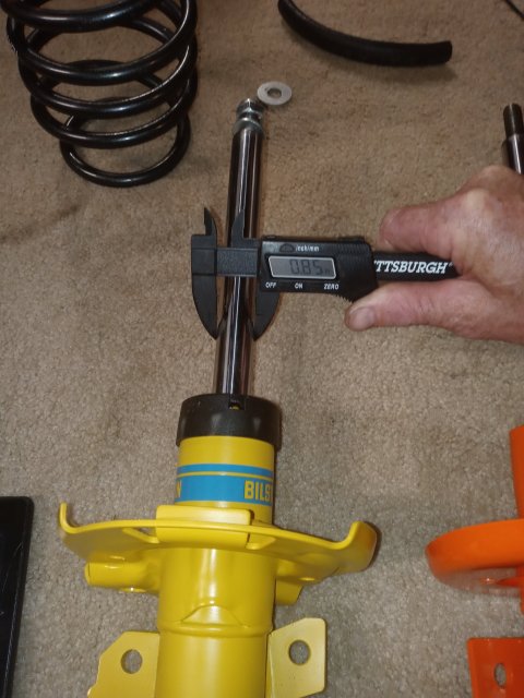

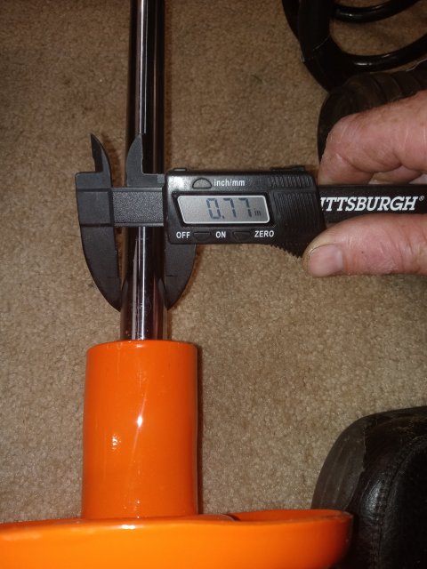

On the B6's the upper bump stop is so tight on the piston that i just squeezed the strut boots up onto the bump stop and called it good! I don't think that the bump stop will creep down at all. But, time will tell.
These are the kinds of little details and differences that can affect what shocks\struts a person might choose if they were aware of them. The Ford bump stops do not easily fit onto the B6 strut pistons. They quite easily move on the O.E. strut and Koni pistons. 20210507_233337.jpg

Excellent point! That larger diameter could throw somebody off if they weren't aware of it. I can see somebody taking a drill and large bit and opening up the ID on the bumpstop, making it too big, then having the bumpstop floating around.
