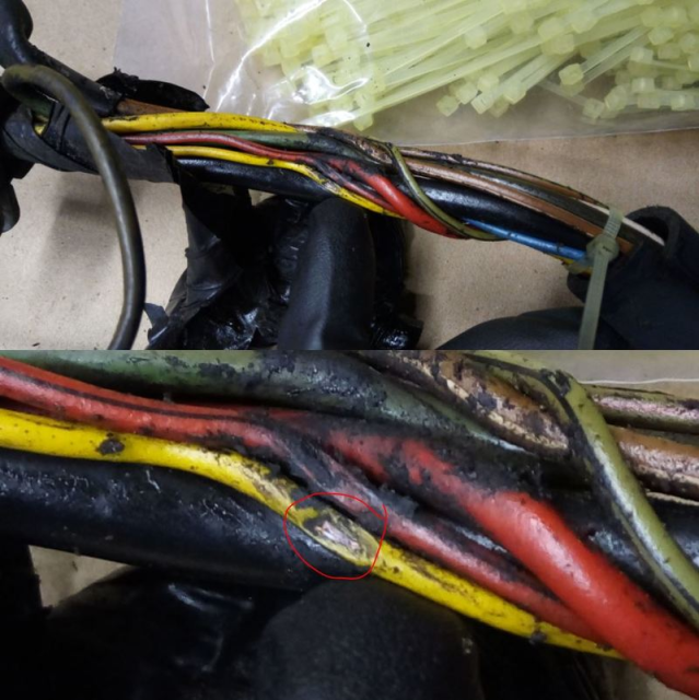

Had any rodents get into the car?
Self-Test Range - kinda far fetched - sounds more like corroded or broken wiring - might be sudden due to rodents trying to nest somewhere in a parked car that has not been used in a while.

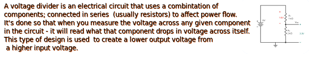

Why the wiring? Key words - Self-Test Range - a type of diagnostic a system will be performed when the car wakes up or has a new battery or if the power cables were ever changed; they interrupted the power in the system - so it does this to make sure that all the devices are getting power and are returning the power to the system in an expected range or value.
The above in a possible example and explanation so you can see how the sensors
using battery voltage as power - are designed to output a signal when all their
input and output lines are properly connected.​

I'd look at making sure all the connectors to the PCM are tight and their pry bar (swivel lever) used to remove or install them (seat them with pressure to ensure a tight water-tight/resistance fit) on their connector are properly seated - also check the wiring harness and inspect it for kinks, nicks and some type of damage - you can see this by comparing the harness to a known good harness in a car or vehicle right next to it. You would not see any frayed wires or corrosion evidence and discoloration if they were normal.
