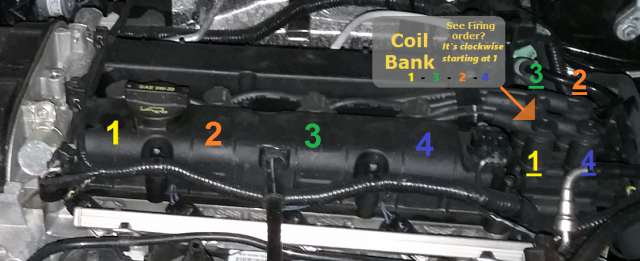

IF this might help...
Read this Thread...
https://www.fordfiesta.org/threads/whistle-and-cough-after-servicing.8939/post-24411
Now if you have replaced the WIRING HARNESS as in the whole kit and kaboodle - that is a different problem and would not necessarily cause misfiring. IF you can re-install the old loom you took out - if it's still intact and not cut up or broken - the issues of a "misfire" can be from other sources - like bad wires, plugs or even the connector to the Coil bank shown above.
When you take on another wire loom, the accessories, the various connectors - everything in it, sat in another vehicle for it's lifetime - different trim models also change the wiring harness too - adding or taking away wires from the loom adding to this problem. Also the age of the loom and the connections in it sat too - so it may have developed a "memory" and now those wires - or connectors can't make the connections to this engine the way the other one it rested in - did. So you may have several conditions happening here.
