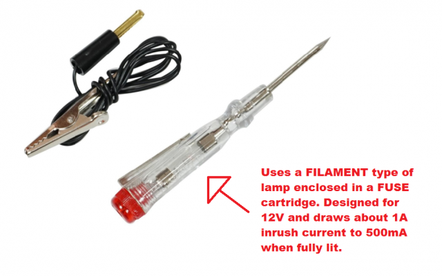

Use a simple circuit checker - the one that lights up when it sees power. You'll need to pull current too, so that motor if it doesn't work, you'll have to see if there is enough current to power it.
A multitester meter is a HIGH-impedance device - means that it is not supposed to load down the circuit it checks. It's designed to measure - not act as a load. So corroded wiring may show good and has power when checked using it, but you might want to check to see if it can pull the POWER needed to run the motor - that requires Current - not just the voltage. but due to the RESISTANCE in the connection at those contacts - the wiring is not able to support the current draw needed by that motor to run (about 2 to 4 Amps) that the switch on the steering column has to support.
Then if the lamp lights, the connector(s) need to be worked up or tweaked to make contact similar to what the OEM original one had used and oriented as, for the original life time it was in that position. So you may need to clean it out. Some people due to the age of the connector - simply buy a pigtail and wire it in to replace the old connector with a new one.

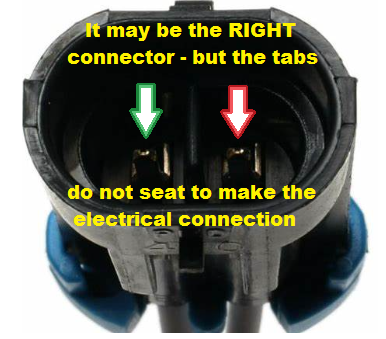

  • It is not uncommon to have the connector and the pigtail - even though they have the same pinout, same connection figure, and even the proper tabs - and tangs male and female - they should fit right?
  • You will need to verify the tabs on the body of the part, will match and fit with the connectors own.
  • This has been a issue with aftermarket and ordering parts for older vehicles that are no longer in production or supported by their automaker.
  • The connection on the replacement part, has a different size tab so the electrical connector may seat, but the tabs never make connection because the tab to socket are the wrong size and or cannot reach their mate in the body of the connector.
