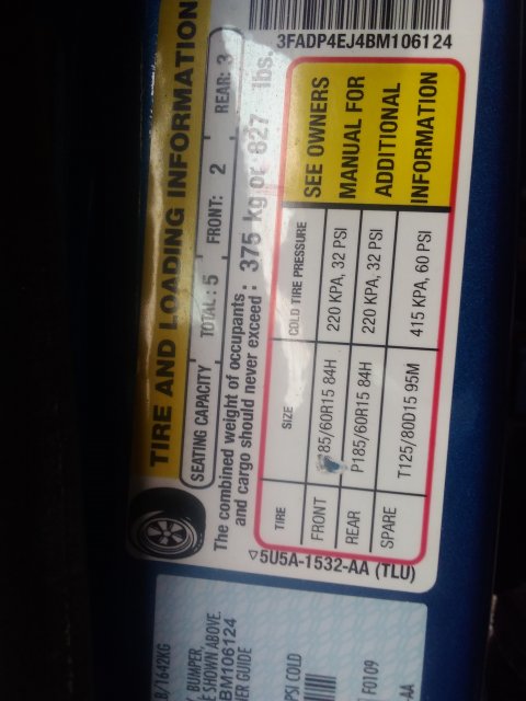

Welcome to the forum. The front left door jamb should have a decal that explains the tire recommendations.

Yeah I've seen that sticker and it reflects 195/50/16 which is the stock size for the ST Line I guess. I'm curious if anyone has up sized and how much can you do before something rubs.
