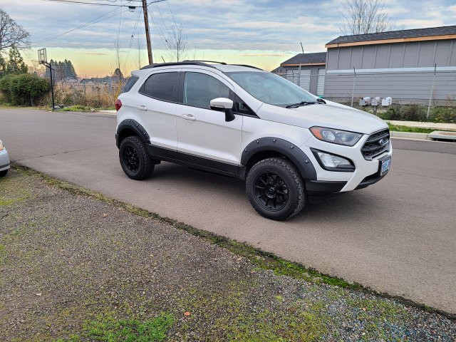

I'm running a 215/65-16 General Grabber AT2 on mine. An 8" when needs a 1/4" spacer a the sway bar link scraped inside edge of wheel with 1.5" lift.

@DeanJ Would 215/65R16 fit without any other modifications? Or is a lift required?

They were fine without the lift. Only had issues when I added a space on the front to fill the fender flares.

Awesome, I’m planning on a 1 or 1.5 inch lift eventually, but I want to start with tires.
I love what you have done with yours. Fenders look awesome. How do you find the on-road handling after the mods?

Starting with the SES helps, but it still handles really well. With these tires it's amazing in the snow. Ford is using them on some of the Rangers now.

Love the aesthetic. Where’d you get the fender flares?

Ebay... Just ordered another set. Didn't clean good enough before I put then on. A couple came part way off and got a little damage.
