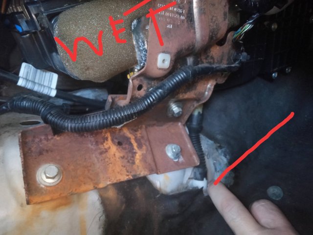

I have just had this problem, remove the inner lower cover beside footwear, if bracket is rusty and foam covering side of heater core/air con evap is wet that's your problem, there is a drain hose going to the floor trans tunnel and will be blocked, have a towel ready, also does air-conditioning blow mist?
