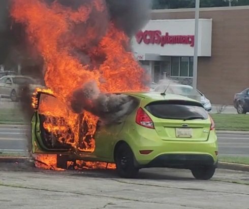

I strongly recommend anyone with the fan vibration to fix it immediately. I had an engine fire that was likely related.
