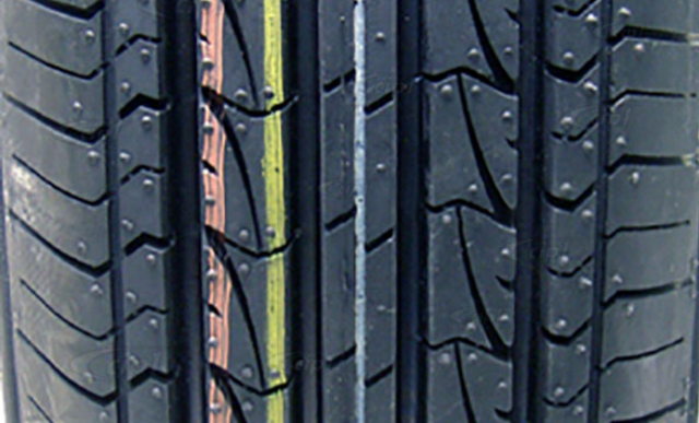

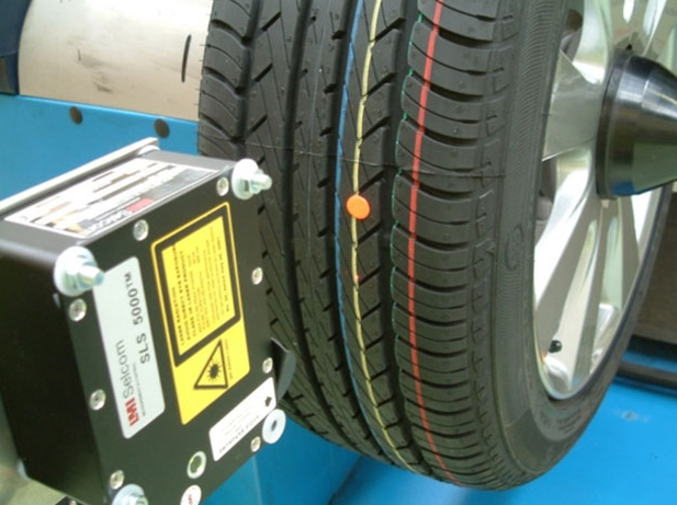

I'm sure you've seen this...
Tire Tread Runout
They use a machine that draws a line on the tire thread as it rolls.
You may see them on new tires to verify to QC (Quality Control or Assurance) that the mold that formed the tread on this carcass was properly done and the tire has been checked for tracking straight.
They also can so this at a tire shop to help the customer see the tread tracking. Any aberrations show up as a drift or divot to help the tire get diagnosed and or replaced under warranty if needed.
