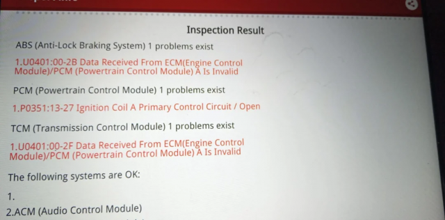

I have a portable scanner and returned a P0351 Ignition Coil A Primary / Secondary Circuit error. I had the ignition coil replaced at a local mechanic. After replacing the ignition coil, the misfiring seems to be fixed:
But when the mechanic had it scanned again, it showed two more errors: U0401:00-2B and U0401:00-2F

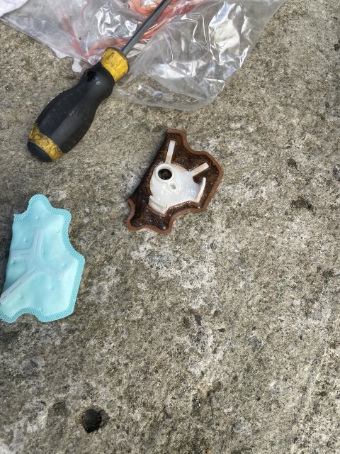

I just had the fuel pump strainer replaced and cleaned the throttle body as recommended by a local mechanic, as sometimes it resolves the problem. After that, I scanned my unit using my OBDII and threw a new pair of errors -- P0017 and P0335. I still need to have it scanned with a better scanner and check if the U0401 is still there.

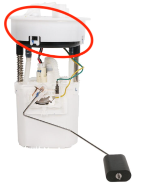

I watched the mechanic remove the fuel pump, which is located under the backseat. He twisted off the metal ring covering the fuel tank using a special tool, as it's quite difficult to remove by hand, though you can try if you’d like. You can also refer to this video for guidance: How to replace fuel pump assembly 2011-2019 Ford Fiesta
Then, inside the fuel pump assembly is the strainer. You have to loosen some parts of the fuel pump assembly to access the filter media (no need to disassemble). Somewhere around the part I highlighted in the image below:
