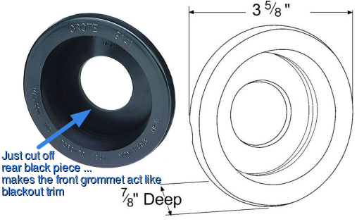

The Fog light blanks use a 3" cutout and also have chrome plastic rings that clip in. They are separate purchase from Ford but you can find other places that will provide them in the kit for an extra $$$.
If you don't want that flash of chrome - you can use a standard 2-1/2" Grommet light with it's smaller base flat cut off and removed to help fit the lamp into the hole and offers a blackout look if you are into that.
Just stretch this over the housing as you apply the front cutout and seam it in
the Fog-light blank fits the cut channels and grooves the OEM blank uses
- the Lamp (with it's mounting hardware) is installed first then the blank
]and this grommet will stretch and slip over the light housing with it's outer ring covering the cutout gap
and provide a nice simple blackout finished look to fill in the ring that Chrome clip-in would otherwise take.
