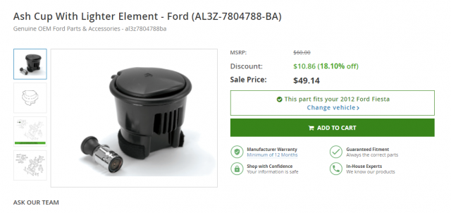

Thanks for the reply, the stock 12v power outlet is not rated for the heat of a cigar lighter so its not as simple as just getting the element and popping it in.
So far I've found the 3 part numbers for what seems to be everything needed for the swap (nobody wants that ashtray haha):
Element: CV6Z15052A
Socket: CV6Z15055A (this *should* be the correct one the stock one is BK2Z19N236A)
Ring: F8RZ15K040CA (this is for mounting and has a light to show when the element is engaged, these have been around for 20+ years)
I also called a Ford dealership to ask about the feasibility of the swap and if there was any wiring/fusing differences and they didn't seem to find any, but I'll pick up a wiring diagram to be sure. So now all that's left is to get the parts but I'll see if I can't find one at a breakers yard to see it in situe and if I can get it for less. Once again if anyone has done this swap let me know!
