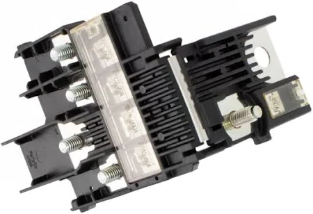

You have a 2011 Fiesta? The main battery connection - has a "Breakout box" bolted to the main positive terminal post. The post itself uses that pinch bracket on the battery post to bolt adapter to bolt onto that box.
IF the wires to that break out box on the Battery are loose - you get messages like this and you'll just need to remove the adapter, unbolt that box, inspect the wiring - clean off any corrosion and use a good grease or waterproofing lubricant on the cleaned connections and reassemble the box to the bracket and to the battery post - it may have lost good connection to pass into that breakout box once you took apart the battery post from the battery - that jumbling may have loosened the wiring and now you just have to clean it up and put it back together.
