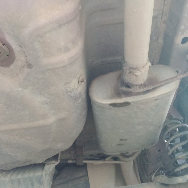

That sucks ,and is not like cat back for these cars are cheap neither ,mine is a J2 engineering that I bought on sale for less than 300, the only issue was the muffler didn't came quite out of flush with bumper like it would on a Hatchback ,I didn't care.
But when the muffler broke, after almost 3 years ,I fixed it with a Magnaflow and a 12 inch extension and reuse the tail pipe ,the only thing I wish I done differently was have him weld the outside diameter and not inside, after 3 months and getting On it ,it broke one of the weld points and have yet to get it fixed xD ,is not loud so i haven't really cared ,they guy even said he Re do it free
