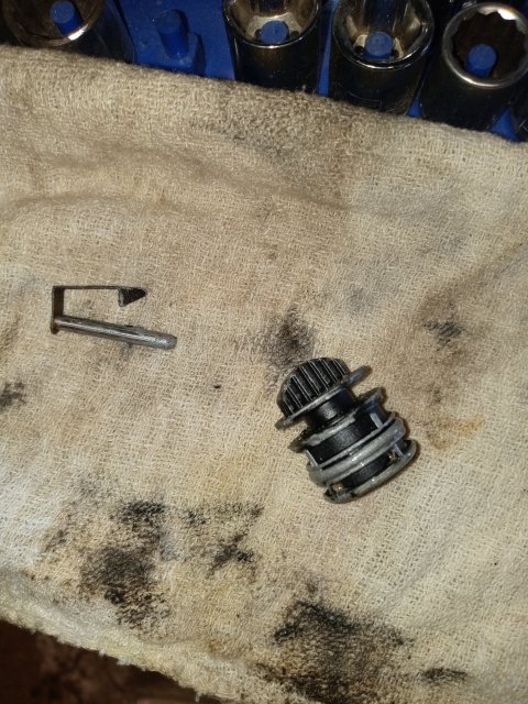

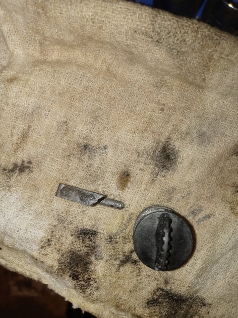

I did a thread in the maintenance and troubleshoot section on removing the plug. There is a picture of the plug and the retainer pin/clip. I need to post up the last three or so images. I have had too many distractions in addition to a bitchy image gallery tranfer app that takes a loooooooong time to move files.
1,972
Images of the fill plug and it's retainer pin. Remove the plug carefully! It's plastic and very easy to break the ear off.

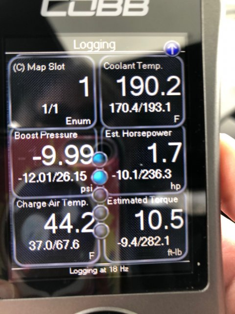

Yup. I've always loved little cars that are fun to drive. I just got a new mountune 93 octane tune on the ST, and I'm very impressed. 236 hp and 282 tq? Yes, please!
