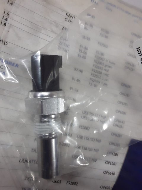

Hey Guys,
So - I have some feedback. Got the new switch and fitted it. The reverse lights sometimes go on and sometimes not.
I tested the reverse switch outside and work fine.
What I did pick up is the "click" noise it makes when putting it into reverse. When it makes the click noise, the reverse light does not go on. When it doesn't make the click noise, the reverse lights go on.
I wonder if the length of the switch is too short.
