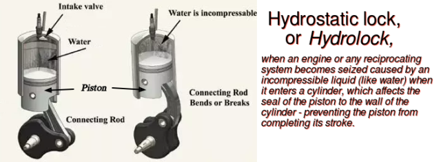

When you run low on coolant - this may mean the engine needs more service than you can afford - the coolant prevents the car from overheating and when it runs low - the head gasket can fail causing these slow start conditions until it warms up. The compression and combustion (power) strokes push air past the seal into the coolant and so its' forced out thru the tank and any other weak seal - leaving you with having to add more coolant on a regular basis - which will get worse in time - to a point where you can't start the car due to a bad coolant leak.
The sputtering sounds like the coolant has leaked into the cylinders when the engine is off - from that bad gasket seal and as it warms up - it smooths out the idle from the heat of the block expands and helps reestablish some seal and pressures in the cylinder itself helps to keep out the coolant from getting into the cylinders and causing the mis-fire. The Slow-turn starts are another level of clues as to the condition - from water (or coolant) in the cylinder affecting compression - a process of hydro-static water lock - this isn't a complete diagnosis but it can help explain the problem.
