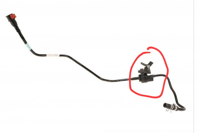

P0094 "Fuel System Leak - Small Leak Detected"
The part that has a small leak is pictured.
After considerable searching I found the part on Partsgeek.com
Purge Valve - 2011-2013 Ford Fiesta VIN J - Genuine, Part No. W0133-3606615
Question is about VIN J
The VIN's 8th digit on the car is
3FADP4BJ9DM161868
Is this the correct part.
I am assuming it is...
There is another part:
Purge Valve - with VMV Valve - 2013-2019 Ford Fiesta Naturally Aspirated - Genuine W0133-4129313
Looks identical only 2 difference are the retaining clips one is red and the other is green and of course part numbers.
The car has the a red retaining clip.
Thanks in advanced.
