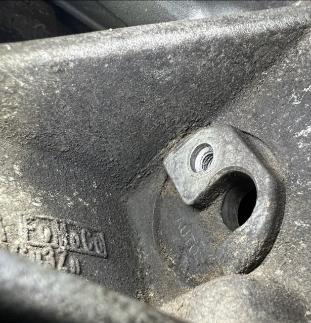

This is the one currently installed. Visible is the word "AUTO" molded into the casting.

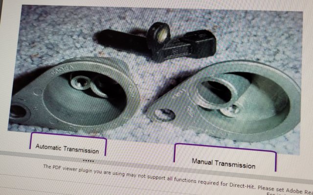

Sorry for the photo, obviously a pic of a computer screen. This is a comparison of the two mounts, as viewed from the Flywheel Sides. I need one as is identified "Manual Transmission"
I would be visiting the nearest Ford dealership parts department. The housing for that sensor might , very possibly, only be available with that sensor pre installed.
It is a logical conclusion given that many components like water outlets that have a temperature sensor already installed.
So, it might be advantageous to have the parts counterman (person?) Look at exactly what comes with that housing.

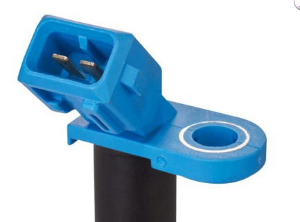

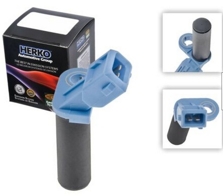

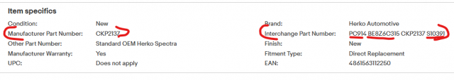

Is this it; says it fits your Fiesta? At least you can see the connector to tell if it's the right one? Doesn't specify a stick or auto. EBay CKP 2012 S; RockAuto BE8Z6C315 & S10391.
But getting the right housing for the mount - might mean a trip to the local junkyard.
The "bell housing" for the two types of transmissions isn't different so they changed the insert that houses the sensor for the two (generalized) types of transmissions they can bolt to it.

That's the sensor, yes. Replaceable from the outside of the motor. Where it mounts to is a separate piece from the block.

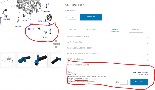

I am looking for the mount that the sensor attaches to/through.
OK try this page. Looks like your need the Shouldered Bushing.
Great Find!
I have a PDF of the shop manual, but it is hard to navigate on my laptop, and I wasn't able to find a graphic like this.
The one shown and identified here appears to be from the automatic transmission version. I'll be looking for one specified as part of the manual transmission version.
