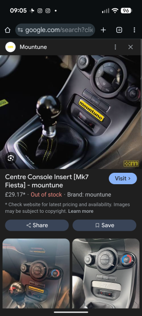

I Also must stop here and ask,,,
What does your front center console look like?
The reason why I ask - earlier consoles have three knobs all the same size - while latter models use three knobs with a bigger concentric in the middle.
The earlier ones were CABLE-driven...using mechanical and wire to move vanes and actuators.
The latter ones were totally motorized and only used motors to move and set airflow.

Mine is the 2 small knobs and the big middle buttons section like this picture.
Also a piece that I forgot happens as haven't turned on AC for a while I get clicking behind the dash where the AC controls are.
