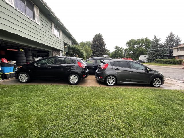

I had it for about a year, put 20k miles on it, and then broke my Collarbone pretty severely, mountain biking. The payments for the car were about the same as the payments for the surgery, so I sold the car after acquiring my 3rd Fiesta, a 2014 tuxedo ST that had been crashed lightly and had a blown airbag in the passenger side .
The second one was a 2015 S Hatch, which had smashed a curb pretty hard and broke the transmission. I bought and repaired it and sold shortly before I broke my collarbone.

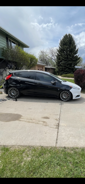

I still have the Tuxedo ST, it’s nearly fully repaired now, and it’s a lot of fun, but I may sell it soonish. I had planned on keeping it to replace my grey one, but…

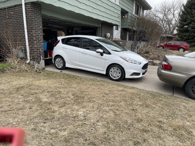

I then found a wrecked 2014 Oxford White ST, and got it for $1500 without the engine, but with everything else. The bumpers, skirts, spoiler, door handles, headlights and taillights were good as was one door and the hatch. The rest of the body was destroyed. All of the mechanical, electrical, etc was good other than airbags.
I found enough used/secondhand parts to hobble together a 1.6 Ecoboost, with low mile stock internals, new injectors, gaskets, water pump, timing set etc for next to nothing.

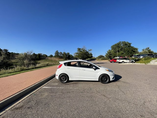

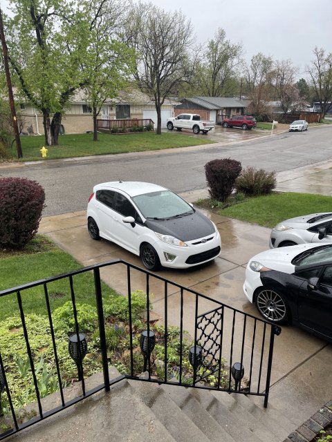

I then found a 2014 Oxford White SFE, with a blown 1.0 Ecoboost, which I got for basically free after I pulled the 3cylinder and gave all those parts back to its previous owner for a swap they were planning. This shell was really clean, no dents or scratches, no bumpers or lights, and it only made sense to do the full ST swap to it.

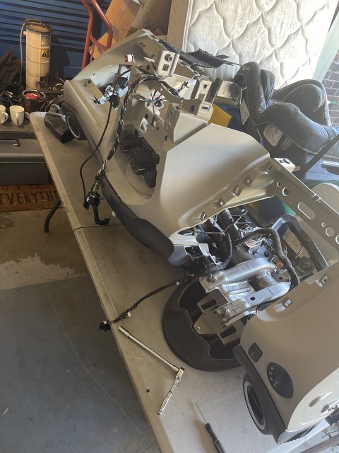

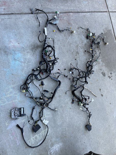

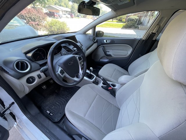

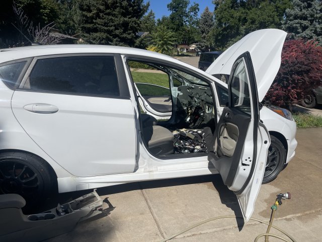

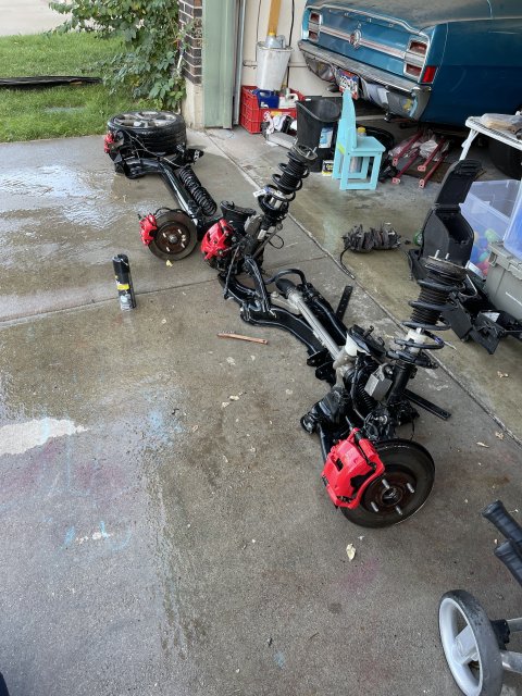

Last summer I did the entire conversion. Sat the donor next to the shell, and meticulously swapped every single part that was different from the ST to the SFE, but I decided to keep the tan interior from the SFE, so I had to rewire the headliner, center console, and dashboard for the keyless stuff, the auto climate control, and the sync3 that I had aquired for it.
The car has been my daily for about 9 months now, and is really nice, drives exactly like my 2016 ST did, but I am into the entire project for less than 20% of what I spent on the ‘16.

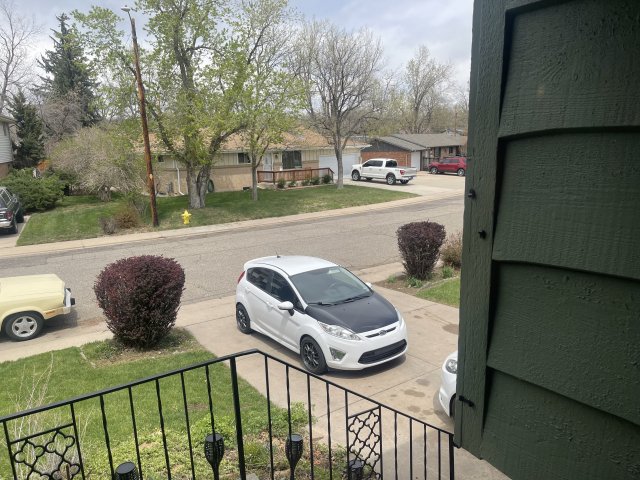

I recently just swapped to the pre-facelift nose and tail lights, as I needed the ST front bumper to finish repairing my black ST. Im actually kind of liking the rounder more polished look. If I could find a 3dCarbon front lip for the early bumper, I’ll probably keep it like this. The intercooler fits behind the bumper fine, and it looks like I’ll have room to upgrade to a thicker one when I’m ready to spend more money on it.

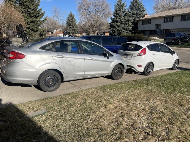

I also just bought a 2011 S Sedan, which has a terrible interior, blown shocks, squealing brakes, and two slipping clutches. I think I’m going to swap the Tan SFE interior into it, convert to power windows, along with a spare set of ST suspension I have, the old SFE brakes which were fairly new, and either replace the clutches, or possibly do a 5 speed swap and sell the selectshift
TCM/Transmission.
At that point I’ll probably put a black interior in my SFE, along with the set of Good Recaro’s that I have lying around.

Nice work, wild to see you were able to pull out the undercarriage motor mount assembly to swap. I appreciate seeing this!
Please keep this going, as those photos can help the rest of us understand the innards of the frame and body - BEFORE we have to learn the process by the method of "As We Go" after the damage has been done!
