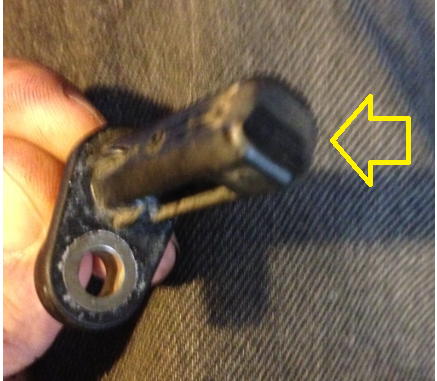

Sometimes the abs wire gets a lil nicked , or the hub gets so covered in mud it won't read right :LOL: ,you can inspect the wires yourself and look for kinks ,nicks , splits or maybe even broken.
for best results in my experience just replace as whole unit

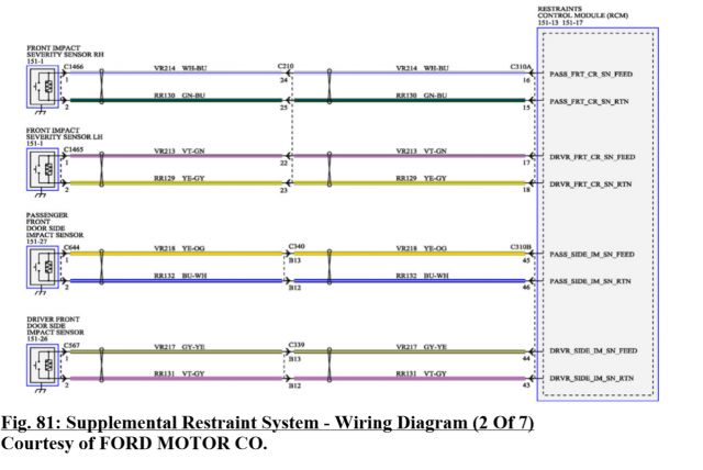

So what @scotman - said about the wheel bearings - those ABS sensors are read by the ABS system - but it also looks at the Airbags (SRS) system at the same time.
Since you're not seeing any STORED DTC codes, the TRAC control system can be directly looked into - better off looking for a bad sensor or kinked / loose connector wiring somewhere - I love the idea of a bad wheel bearing - that would settle a lot of issues with bad sensors - seen those get sawn off by their rotary toothed wheels that they look to for, being that they "see" reluctor operation (hall effect devices)

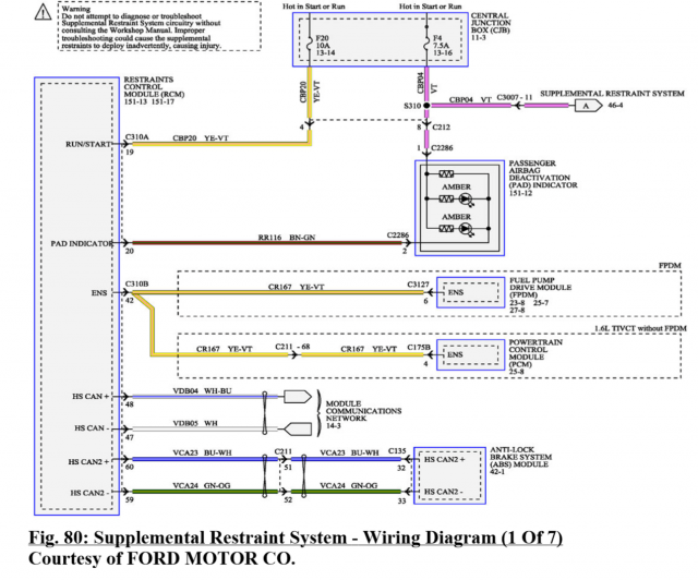

But it's the U0401 from the ABS system - has me concerned...
The ABS is questioning the validity of PCM data - it's losing host communication.

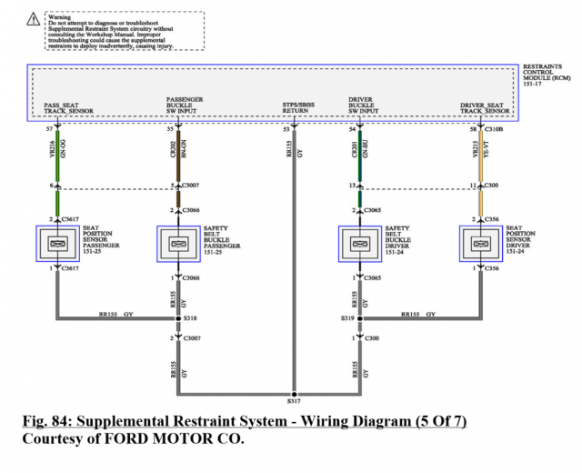

So that could turn on a TRAC light - gotta take apart the console and look for the RCM module - it's right under and just in front (or behind it towards the rear if your looking from the drivers side at the shifter) of the shifter. You have to go over the wring - that Airbag unit also is working with the Restraint system to detect and offset the loss of traction and changes in direction of the vehicle is can sense as part of its SRS (Supplemental Restraint System - or AIRBAG) so that one module interconnects all those airbags and those impact sensors - and use the High speed CAM side to communicate to the Antilock braking system.

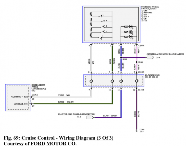

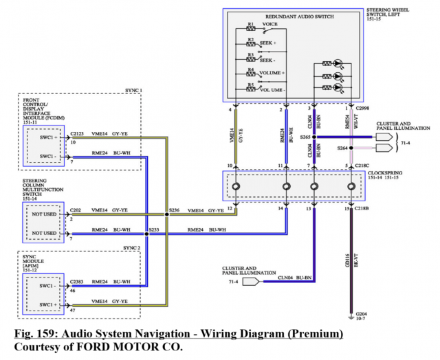

As I was going over your post earlier - I also need to mention about the work you did to the Steering wheel to get the audio functions working again. There is a 2-section wire harness that interconnects the wiring in the steering wheel, with a STATIONARY connector that bolts to the steering wheel column then it goes into the wiring harness and branches off from there. The main harness that is stationary is brought to the side of where your high-bean and flash to pass column switch is on. From there it turns into 1 dedicated Airbag harness and another smaller "Y" breakout harness for the Audio and Cruise control.
IN mine the second piece of these harnesses, the Airbag harness is yellow sleeved and connects to a blue box connector - while the other functions like Audio and the Cruise control - are through a 16-pin connector - again mounted by and at where that Airbag harness goes.
These two thread thru the main steering wheel "well" that houses the clockspring - this helps center the steering wheel - the sleeved wires are just long enough to let the wheel spin equally in either direction without pulling the wires or their connectors taught and doing damage - yanking them out.

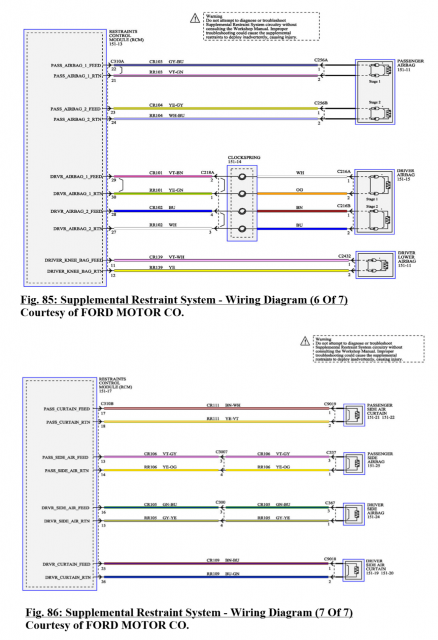

The ABS airbags in the main horn section - you have two bombs wired to go off to inflate the main steering wheel airbag - so if you have done work to the controls on the steering wheel, this can affect the wiring - not necessarily there, the clockspring would and can still damage the harnesses that are designed to take the twisting of the steering wheel and survive for the lifetime of the steering column and wheel.

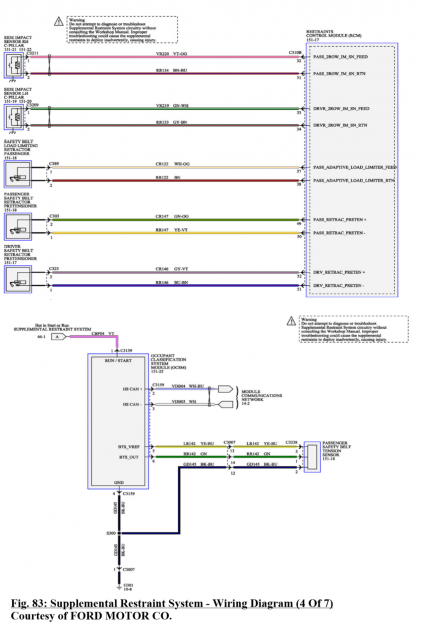

So just double check your wiring fix so you can avoid more damage to the system - the other part is with the SRS/RCM (Restraint Control Module) - that module is the one that looks at and communicates with ABS module at the ABS system inside the engine compartment.
So just verify you're not scraping or scuffing a pinched wire somewhere...
