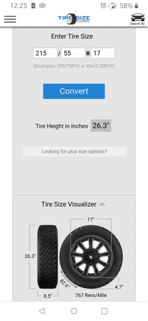

I think this tire will work. I'm about to buy these and a lift kit at the same time in case I need it to fit the tires, but I doubt the lift kit will be needed for such a small increase in size

Has anyone figured this out? I got a 2020 Ecosport Titanium AWD (USA spec) as well. I wanna run the same 215/55R17 tires on my Ecosport. And if a lift kit was needed what kind of kit was used???

Stock: 205/50/R17
Diameter 25.1
Width 8.1
Sidewall 4"
Circum. 78.7"
Revs/Mile 805
I'm looking at 215/50/R17
Diameter 25.5
Width 8.5
Sidewall 4.2
Circum. 80
Revs/Mile 792
Wider, a little taller, but not too tall. I've already bought lighter wheels to offset the increased weight of the larger tire to keep the unsprung weight down.
