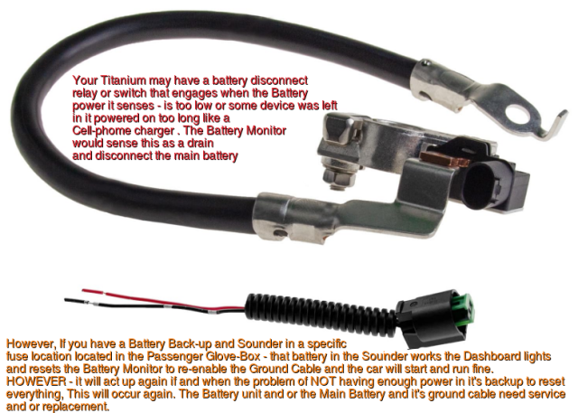

Since you own a titanium - this may not be an issue with the keys, but of the Battery Minder (Monitor) circuit and it senses that the power level has dropped while it sits, so it disables the relay - the one on the battery cable ground.
So the issue with that - you may have two lights on your Dashboard, one that looks like a Battery - and another that looks like a Voltage pile (a schematic version of a battery symbol) that may also indicate a secondary battery that needs service or replacement - this may cause the issue of the starter disable - not enough power to reset the battery monitor so you'll need to inspect the engine's main battery and also the fuse-boxes - both; one outside in the engine bay, the other inside behind the glove-box - the Owners manual would show "Battery Monitor and Backup Sounder". That fuse may need to be checked and if this still happens - you can try replacing the main battery - but check with your dealer and see if there is a backup sounder unit (a separate alarm) that contains this extra battery as a backup to re-set the system so you can start the car.
If it has one, that battery in it may need to be replaced.
