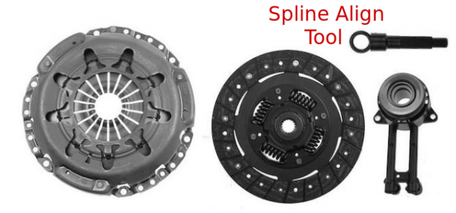

@Mercurios2011 - thank him, he gave you the biggest clue - after a clutch replacement - the OEM plate doesn't always need to be turned - but if it's bad, they have to replace it with an exact OEM one.
So not sure of the LUK clutch pack install had to make any changes to the flywheel you had used Originally - until this replacement.
Then too, if the whole transaxle and manual boxes had to be dropped to do this - the codes show it's highly likely it was not re-seated correctly.
This may also be giving you a sign that the clutch to wheel alignment might be a touch off. - There was supposed to be a insert tool that goes with this kit that aligns the pack to the plate - did they use the tool?
