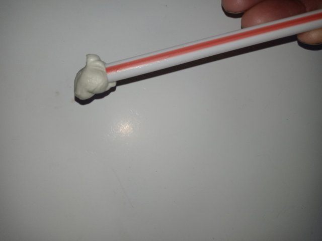

In the rare occasions I find bits of insulator in the plug galleys of twin cam engines, i take a McDonald's drink straw and a bit of freshly chewed bubblegum to dive in and grab the chunks. 20220702_083002.jpg 20220702_082540.jpg
