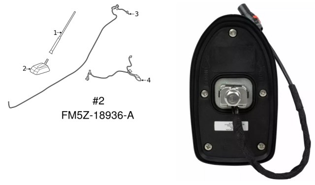

Depending on the year, and since you're outside of the USA, this may not be able to help but I'm trying.
If you can, the old antenna - do you have the old housing? The cable might help you decipher what you really need to have.
The year is why I can't "pin down" a good concept except to see if you have used antennas from a wreck-yard - that have a similar cabling system.
The reasons on this - one of the cables power an amplifier at the rear antenna base, while the other coaxial cable sends the signal back to the Audio Head unit. The whip uses a twin-coil wrapped in plastic, one for Medium Wave (AM) and the other for FM.
However, the catch is the security and RF-ID for your remote - that receiver for it has two possible locations, front windshield and the rear antenna - both serve as pickup and if one works - great, but both are needed to really access some extra features that are only possible if the RF-Passive entry system is present.
I'm adding here...-stay tuned...

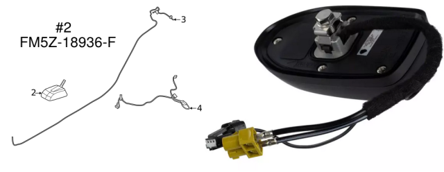

Now, granted you may not have all those extras, so this is why I'm taking this approach - the recommended ones are shown.
You may be able to use a Fin-style but the cabling and the connector used, as well as the equipment it's designed to be interfaced with, will be different. Shown above - this is presuming you do not have SYNC - you may have the FORD Audio System - not SYNC - both use satellite but cable the signal in different ways.
Notice the connector will be different and is for SYNC and above in revision.
