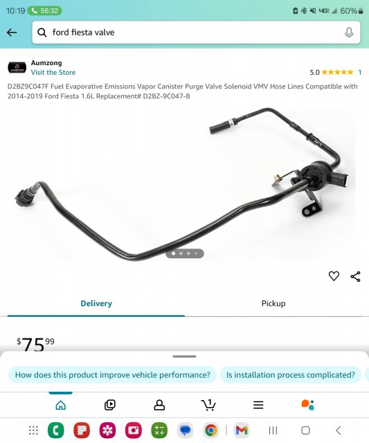

Honestly, that a good set of parts to replace at that interval. The only thing I would recommend is the is the fuel evap purge valve. i havent reached 150k but at 89k my started clicking fast and loud then I filled up my tank and the car wouldn't start. It's super easy to replace and takes 15min tops.ill attach pictures and videos

Hello rmart2019FiestaSSedan!
I hope you are having smooth drives on your ride!
I actually had my fuel evap purge valve replaced
at 110,00 miles, and I had the same exact problem
that you had, where I would fill up the tank and
try to start the car. Since my battery was replaced
at 80,000 miles, with my alternator replaced at
85,000 miles, before my starter was replaced
at 90,000 miles, prior to my ignition coil replaced
at 95,000 miles, I was trying to figure out what
the problem was. Fortunately, my mechanic made
an accurate diagnosis and verbally stated that
the problem was the fuel evap purge valve.
Each time I filled up on gas, no matter if
I used 87 octane, 89 octane, or 91 octane,
I will still have to floor the accelerator pedal
until I could get the car started. When the
fuel evap purge valve was replaced, the
problem was solved. Thanks for uploading
the color schematics for the parts involved.
I will also keep your comments in mind for
the radiator, the fuel pump, and the oil pump.
Thank you rmart2019FiestaS!
