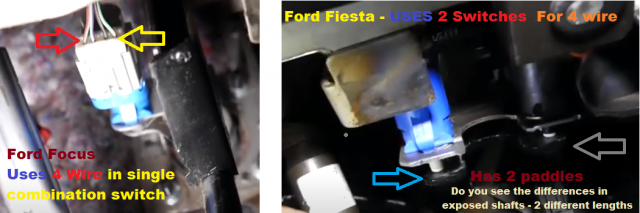

  • One pair of wires are used for Transmission - the other set is for Brake light and BCM.
    • Manual uses the two - one for Brake light the other for "Idle up" take-off
    • Automatics use the two - One from Brake Light - the other for Transmission Solenoid engagement control
  • Ford Focus - uses this as a COMBINATION switch - one housing - two separate contacts same results
  • Ford Fiesta - two separate switches with PADDLES that can be adjusted to set ASPECT of which engages first to help in control.
    • Aspect being - one Control switch can be tweaked to act AFTER or BEFORE the other one to alter the way the system handles braking and transmission control during braking.
    • Setting both to engage at different positions of the Brake pedal application - changes the way the PCM/TCM processes the braking action.
    • These also are putting (pushing using spring pressure) on the Brake Pedal Pushrod
      • - setting the paddles too close will force the brakes to drag or engage while the switches are not set properly to release the system to handle braking
      • - you want to set the paddles to engage the brake light but also set the transmission control to disengage - or release power to prevent overpowering the brakes when you're attempting to stop and possibly stalling the motor as well as extra wear on the transmission you don't want.
