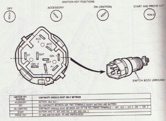

Representation to show connector to keyswitch as a factor of assembly
Does not represent your vehicles' ignition exactly
  • In the above graphic, I only want to show you how you'd see the ignition key working a set of contacts that electrically function as current carrying load switch.
  • Battery CONSTANT is applied to the switch as a "Mains" while the rotor then selects the ACC, Ignition, and START as secondary distribution
    • Within this is each contact is then supplied by MAINS to handle it's own load and power routes from that section of the switch thru a contact or as a set of BUSS contacts to distribute their power to various systems.
    • When the contacts see a heavy load, that power still routes thru their set of contacts as a demand placed upon it from the MAINS (BATT constant) but as with any switch, even relays,
      • their points of contact are having to carry that load
      • - have a level of resistance that is a factor of construction
      • - if the contact surface is small, like a point contact, the load and power LOSS is dissipated by the resistance the contact is, turn to HEAT that needs to be dissipated, that if not large enough to release to the air or frame cross members used to hold the steering wheel, instead it builds up inside the tumbler and transfers the heat to the key inside.
So if you remember the days of when Keyfobs and your house keys shared the same dongle and lanyard, then you also remember those times several attorneys decided to sue on behalf of their clients - against Automakers from making the "Steering wheel Lockup and Lockout" a factor in collisions - being that if the weight of all that crap on the lanyard was enough - it can force the key to turn to the OFF condition - locking up the steering wheel preventing it from turning and shut off the engine and turn off the Air bags - as the user simply watched helplessly as the object be it a tree or other vehicle - loomed larger and larger in their view of the windshield - until impact - and since Air bags need power to deploy - well, that help never came...
