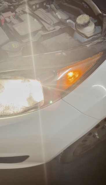

Hello, this problem literally developed overnight for me and I have no idea how or why. I have a 2014 Fiesta sedan, and the left headlight beam “leaks” a sliver of light out 90° to the car. I was on the highway, and I was illuminating the car beside me. Most of the light still goes forward, but that slit really distracts me, probably because it wasn’t there before. I attached a picture that shows me nowhere near the front of the headlight and still in the bright portion of the beam. The right headlight doesn’t shine there at all.

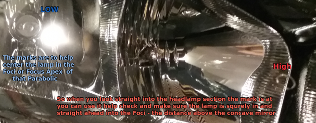

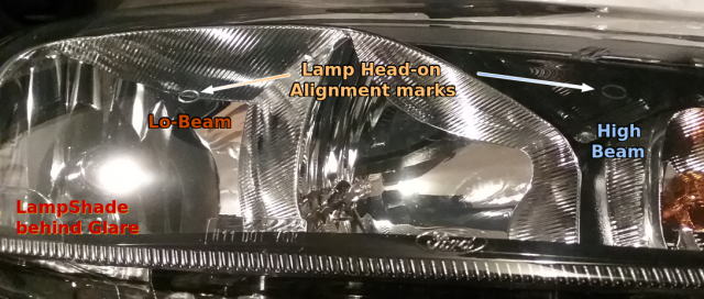

Throwing this in this post so I can find it later...
The above is the LEFT side headlamp from a 2018 Fiesta - many that own older headlamps may not be able to see this detail due to the abrasion and scratches the surface lens cover suffers during normal everyday use and fading from sunlight.
The Marks are for helping to align the lamp to the parabolic mirror - both the High and Low beams are "offset" in their holder to let the mirror they are housed in, reflect the light properly at the right angle.
But, in hopes to help others, the parabolic reflector is similar to a concave mirror - only it uses the headlamps filament - positioned in a specific stationary spot, to deliver a focused beam.
To allow for greater shape of light aim and it's appearance in pattern - the reflector is shaped and uses forms of the different patterns of the concave shape to offset and augment the effectiveness of the point-source light to make the shine more efficient and effectively aimed to offer better visibility in various little to no-light situations.
The Lampshade itself is for the light to be bounced and sent out using the mirror - and because of the styling of the vehicle - the lamps are offset and headlamp shape to the fender- the design compromises this so they do a best fit for shape and function.
