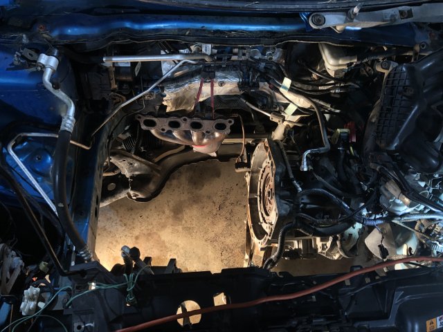

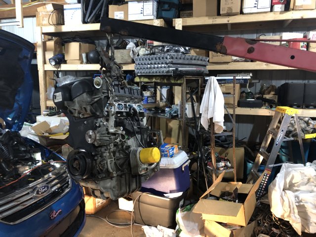

Engine is out. It’s in the garage, which is normally the home of my show car. Took me 12 hours yesterday, about typical. Hood stayed in place. I removed the passenger axle to keep it from getting overextended or damaged. I just popped out the balljoint since I just did those last winter anyway.
Only thing that broke was the starter solenoid, which would have broken regardless. Trigger wire nut was so tight it took 2 stacked vise grips plus wrench to remove the nut from the terminal. Can’t believe how much starters are for this thing.
In contrary to what the other guy said, there is nothing wrong with the water pump. It must have slowly lost coolant from the broken hose at the overflow tank.
Still wondering if there are any common issues on these engines that would be better fixed while it’s out/apart ? Like for example, the distributor O ring on the GM 60 degree V6. I would definitely do the timing belt and water pump.

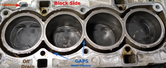

The engine block and the head need to be checked for warpage - else you may not be able to reassemble it right once the new gasket of this original motor has been changed.
When you remove the head, you'll see that the cylinders appear to "float" in the block when you look from the top-side down. The block itself is merely a container for the waterjacket the upper cylinders have around them. This is how the motor even works - the fluid carries the heat away while the sleeves transfer heat from their chambers. The Gasket itself is adjunct - which keeps the cylinders from bleeding - blowing into each other - but there are areas of concern where there are gaps in the joiners - the cylinder to cylinder sleeves - that let fluid in to cool that section. If these get caked with debris, the effort to restore it may be pointless for they may have developed minor cracks and will fail soon enough - meaning replacing the gasket is only buying time. As to - how much time? Depends on how much the gap is plugged from debris or caked with sludge from the radiator fluid and oil mix.
The Cylinder head receives the fluid and pushes it out the outlets in the back.
So gotta' keep the ports clean so if you decide to change the gasket - make sure those areas are clear of debris and old oil.

Thank you for this. I took this one apart. No damage to the gasket itself. But both the block and head face are .005-.006 out of flat. Dished in the middle of course. The manual says .003 max. So that .010-.012 total gap in the area between the two middle cylinders explains the compression test results. The head also lifted right off upon removal of the bolts, it wasn’t stuck down or anything.
These engines just seem so delicate compared to what I’m used to. The almost floating cylinder walls. The “joiners”, which have nearly nonexistent depth on this engine here. So I’m guessing it was faced before, and the gaps were mostly milled off.

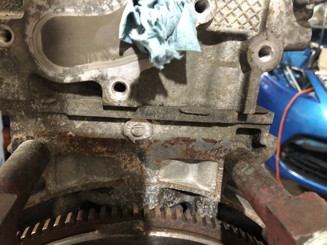

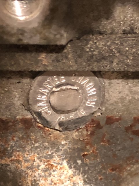

One thing I noticed that isn’t on the old engine, is what looks like a snapped off stainless bolt at the top center of the block, between the two top bell housing bolt holes, with a little sealant. Around it in a circle is stamped “guaranteed, void if removed” or something like that. Maybe this one was a reman at some point? I can get a picture tomorrow.

So you know, the oil pump is at the crank, base of Cylinder 1 - make sure they didn't smack the harmonic balancer out of true and it now wobbles. The bottom crank uses a gear with no notch, clutch, dog or stopper - it uses the friction of the gear to crank clearance to friction grab and hold fast. (I hope this is not the double "dink" effect from wobble causing this)

Today after work I tackled the broken stud. Tried 3 times with a welder, just kept breaking more off until it was deep in the hole. So time to drill. Almost to the end the small bit broke in there. So I got as far as I could. Tried a bolt extractor. With a propane torch aimed on one side, heat gun aimed at the other side, tapping on the extractor with a hammer to keep it seated, holding rotational pressure on the extractor with a wrench, all it did was strip my wrench. Got creative and hit the broken bit with various nails to shatter it. Eventually broke off the end of the bolt inside. So drilled the remains to size and tried to tap, but the threads were hopeless. So I did what I’ve done before. Drilled out the threads and tapped it for a steel pipe nipple (1/8 npt in this case), screwed in the nipple and ground it flush, and drilled and tapped that. Will be at least as strong as the original aluminum threads. After messing with it for 4 hours tonight, finally got that part fixed.
Thursday the last of my parts should be here. And I will probably get started Sunday, we are going to a concert Friday/Saturday.
Here’s a pic of that weird plug thing, and another to show the location.
