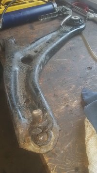

The NAPA premium unit might be a Mevotec. With the roads I have to drive on here the greaseable option is key. With proper periodic re-greasing, a ball joint will almost never fail and will last through much more rough service. The Napa premium also has a metal bearing/socket where as some cheaper brands will use plastic...no bueno!
Ball joint 101
