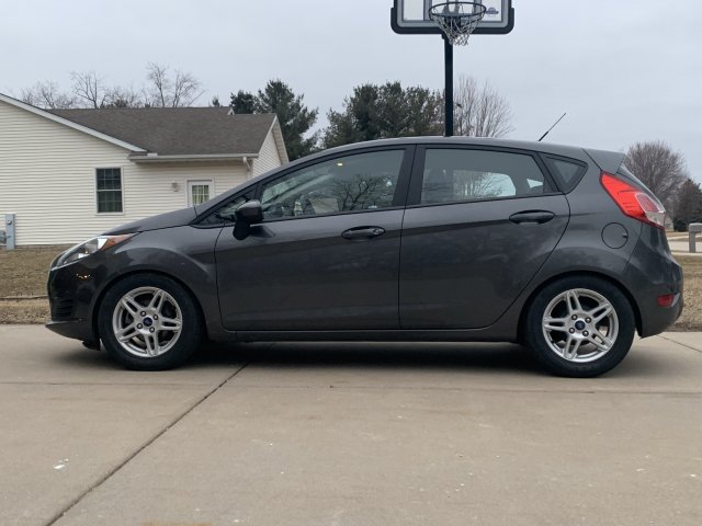

Ronaldo
Geneseo
IL
17fiesta se 95mustang 94vette
I just installed the H&R 51641, looks and rides great. Dropped it about 1.5" but I am really impressed with the ride quality.
