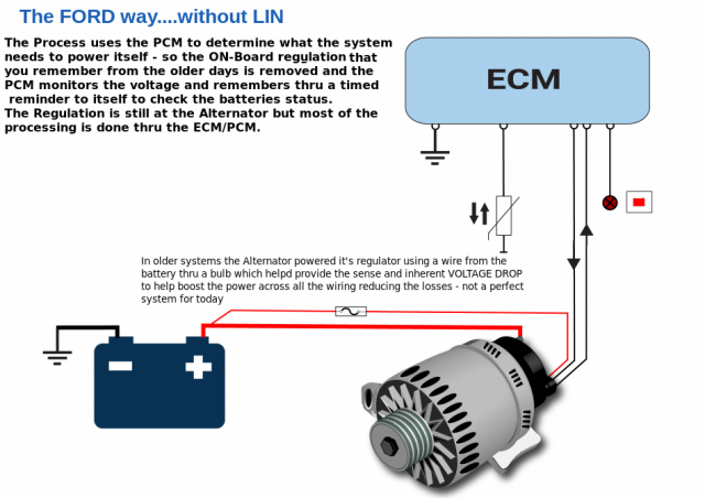

Today's cars - the Alternator is no longer a "self-sufficient" charging system. It now uses the PCM to help develop an energy budget, so it uses a means to talk to the Alternator so it can produce the power at moments of need at greater rates than would be safe for the battery and or the system itself - for the surge could damage the parts connected within. That's why I mentioned the LIN system, it's like the older telephone systems - they supply DC power to the phone but can also send voice and data - we eventually worked it into making PC's talk to each other like modems did back in the 90's. The LIN system uses the DC power and Telecommunication transfer technology to listen for commands and even send data back onto the line for the PCM to interpret a condition and if properly programmed - make up a budget to handle the demands - Like EPAS and ABS / TRAC-control systems along with lighting and regulation of power to keep the system working and charging.

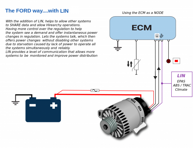

  • That the reason for the LIN - a type of monitoring the PCM can call out to. It's used to verify the integrity of the system - it's not foolproof. In using it in a simpler system like the Fiesta - in it's simpler form - can only help in those pinches as needed to operate heavy current demands. But, in other systems from FORD they programmed it to become a reminder so the Battery itself can be checked and "tested" by the system and notify you to check it. Some Titanium and Platinum models (upper trim lines) have this LIN as a Battery Minder System (or similar wording)

That’s interesting. The LIN system sounds great but it takes me back to why I like older cars. Simplicity! It has too many failure points. Very cool tho.

The system, when it doesn't "hear" or able to see changes when it calls out to it, can set a series of DTC codes. The Check Engine light would come on and you'd see the DTC's starting with the Letter U - they'd be in your HEC display when you press that button to find DTC codes - they will start with the Letter U while other will start with B P or C related to the type of code support and parts related to it.

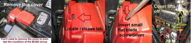

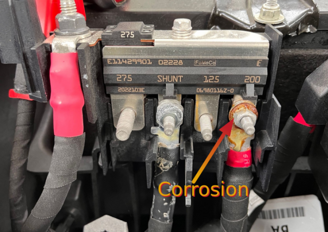

OK, here's an idea - didn't know if you could "Load test" the battery once the car is started, put a halogen 12V lamp light across the battery posts Positive - to lamp to - Negative - something that draws current.
When you leave the headlights on, that automatically shuts them off once the key is turned from RUN to ACC or off - that kills the headlights.

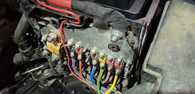

Those plastic cap covers do pry off, they protect fuses that use screws and bolts to hold them across a open bay in the BJB so the fuses are the jumpers to power the terminals below them. So if these fuses are corroded or the screws are bad, then it can cause this intermittent problem that only a current (READ:Heavy) load will show.
What is the purpose with the lamp? To load the battery directly with a load on the posts - once the engine is started, let it run for 5 minutes - with that light being hooked up near the end when you're ready to shut off the engine - for the light will get hot so if it's bright - great - but also check the positive wire of that lamp on the other positive terminals of that Battery Junction Box and see if the light is still bright as the engine runs.
  • A good setup is to use a Phillips (taper sharp tip tool) to a lamp that needs some current to start it illuminating (like a Fog light or handheld spotlight using a Halogen bulb Fused to protect you and your work) with the GROUND wire to a pinch clip clamp to hold it to a good grounding point - and you tap the tool to see if the bulb will light.
So then you turn off the motor - stops the engine and now look at that light - it will dim down, but check those terminals while the engines off. You're looking for a "dead circuit" or corroded wiring - the light might get even dimmer or nearly dark. If none can be found you might have to check the Fuse-box in the engine compartment.
But if it's going dim or winks on then off then back on, you may have loose fuses or bolts used to hold them down, need service - there's your evidence of bad or corroded wiring - that terminal has either a loose fuse or the bolts used to hold it to the BJB are loose - making the light, being the load, intermittent.
To give you an idea of what you might be up against - I'll give you some quick examples of other Ford designed systems for their Junction boxes that break out their power to subsystems EVEN BEFORE THEY GET TO A FUSEBOX!
Ford Escape:
Ford Focus is similar to this...It can be found here
FORD F250 used an INTEGRATED Fuse terminal system
These designs are previous efforts, the Fiesta is simpler, so the BJB doesn't need all those terminals
- but the above designs and their bolted fuses carried thru into the FIESTA.
So be aware of the loose hardware and broken even corroded wiring issues previous versions had.​
