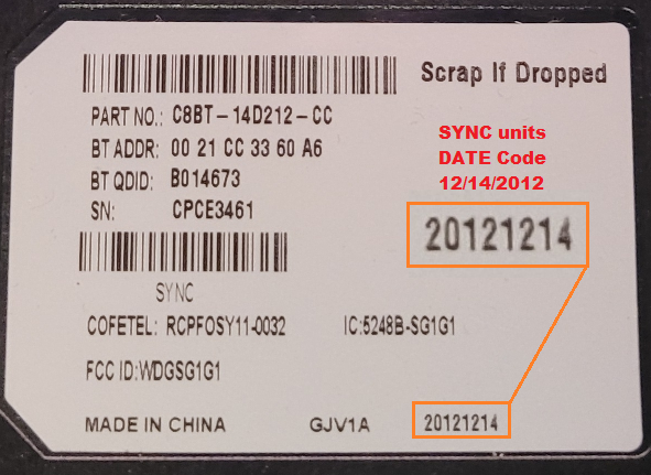

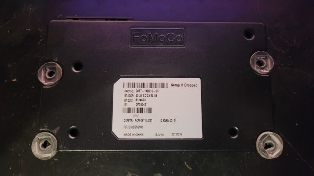

Hello, I am the owner of a 2013 Fiesta Kinetic Design titanium and the sync 1 module was damaged by water. My fiesta is a mexican unit, so it should be either the same or very similar to the american fiesta. Over here my OEM replacement sync module costs about 1000 usd and for some reason there are no used ones. I am not willing to pay 12% of the cars value for just a module. I would love to know if the module is replaceable by another one with a different part number (Mine is C8BT-14D212-CC). I found in Ebay lots of modules with the part number D1BT-14D212-CC (Is very similar but misses a secondary mini usb port which my module has but my car doesnt use) and cost no more than 80 usd. I also found lots of Sync modules in Mercado Libre (Argentinian Ebay) with the part number AM5T-14D212-KD, BM5T-14D212-KB or FR3T-14D212-GA which cost no more than 70usd and come from the brazilian manufactured fiesta. All these modules also lack the exrta mini usb port, but once again, my car only had one mini usb connector for the module. Is there any way to know if they are interchangable? Here's the module:

There's some stuff that you might need to know to help you in your search - because to make this more of a "Drop in" the technology around it needs to be kept similar - else it will fight you or not even be recognized due to the differences in the CHIPSET as well as the Programming it needs to be seen and work with the system it's going into.
You already know the part number, but the BT identity (no; not referring to the address - just having BT compatibility) and FCC ID - should be kept the same - this tells you that you have the same technology as the broken one - and having a unit closer to the Date code helps with the version and the last update it could have in it before it was installed in the other junked unit.
In another thread, you may also encounter DTC and error codes during this install - the SYNC unit "copies" and even becomes the sole heir to - a lot of data when the car sits. So this may have crash data as well as the other vehicles' configurations and error DTC codes stored in it - so to keep this simple - just be ready for a fight during the install.

The PCB is completely eaten by rust. Previous owner (My mom) didnt clean sunroof drains all that often so lots of water came into the car.
