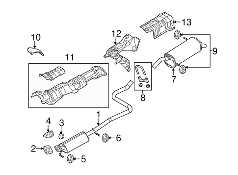

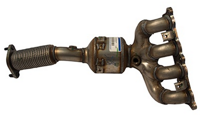

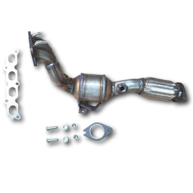

It may be a case where the repair shop is trying to sell you a catalyst with flex pipe. Rather than just the flex pipe. The images of the area show the flex pipe is welded onto the end of the catalyst. It's possible that the car has hit something in the road or been driven into a ditch and the catalyst and pipes are bent. That would be a situation where parts might need replacement.
If not, then a simple and inexpensive flex pipe section should be doable. You really need to have it fitted and welded into place by a shop that is capable of doing that type of thing. And they should also be capable of explaining in clear and simple terms the scope of repairs needed. 20210324_115315_clipped_rev_1_900x-1.jpg
