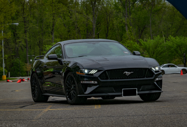

I have read that with the FOB you just need to program and add two fuses in the fuse box, have read a couple people mention cruise control can be added with just a wheel change (as long as it has the harness) and FORSCAN tweaking. Was just seeing if anyone has played around and what the success rate was. I believe what I was reading was people from UK region so like you mentioned maybe completely off the table here in the states. The Fiesta is just my winter beater/commuter, the attached picture is my toy with all the bells and whistles.
Ok!, you know what you want and have realistic expectations. I also have a Mustang, it's an antique one. Is the one you have a PPL2? I am trying to stay current on spotting the hot variants of my first favorite performance car.

The Mustang is a 2018 PP1 with the MT-82. I also own a 1987 Mustang GT that I started building years ago but was put on hold due things I couldn't control and is in some need of restoring. That's another reason I bought the S550 a couple years ago. My son has a 1997 Mustang Cobra that is IRS swapped and T-56 swapped, it makes around 310rwhp. Engine already has forged internals and suspension work has been done as well. His next project is boosting it. So in the end I know how to tinker on cars just didn't want to put a lot of effort into some possible cheap upgrades on the Fiesta if it wasn't possible. I will try to post some links tomorrow of what I was reading and maybe you can tell me if it makes sense or possibly can be done.
