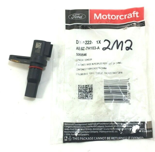

There is also - and you didn't give a lot of details so forgive if this seems to be overkill but you did ask...
There is also this...
This is the OUTPUT shaft speed sensor for Automatics.
So if you did fronts - there are several places something could have gone awry
