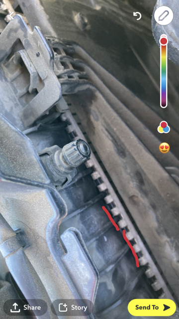

Let me show you these photos. Probably make things a lot easier. Haha
So the coolant builds up all along the radiator (red part in photo) and drips off towards the passenger side. It’s definitely coolant too. It’s super low. Like I said tho. It really only leaks with the AC on.
So it the radiator, right? Where would it be leaking to make coolant build up like a river on that spot of the radiator?
It’s gotta be the radiator, I’m my opinion at least

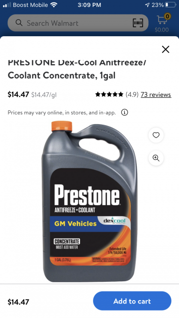

Also, will this work? I’m pretty sure it’s orange and not pink. Why’s the pink stuff? I’d like to go with what’s in the car already. This is my first car that takes dexcool. Usually just run the classic green stuff.
The leak is from several events,
I think your best option is to stop and just add fluid - your radiator is pretty shot - that white residue is the leftover remains of the coolant.
So if your see the actual coolant leak, that seam between the plastic and the aluminum core is shot.
Don't need to play around - just get it replaced.
There are several YT vids about changing / swapping out the old and replace with a new - but those links are vehicle specific to show how that individual replaced or fixed the condition - but can provide a general knowledge of how FORD manages to put these cars together.

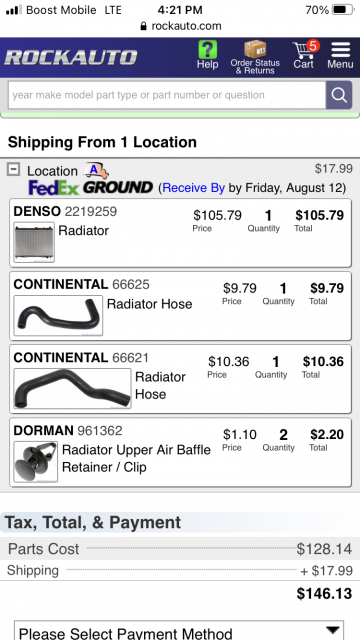

@Handy Andy check out the parts list. Am I missing anything.

Yes, one of these...
And make sure your "burp lines" are not compromised, else you'll need a pair of those too - your hose will be snaking into the mess around the thermostat housing, and it uses plastic, so if the old hose doesn't come off easily, carefully remove the shorter hose from the CAR side of the thermostat housing - give you more room so you can grab and twist without breaking or tearing any more hoses
Those plastic plugs that go into the old unit - you can reuse them if careful with removing them from the OEM - if not you can check the box and see if the plugs are in there instead.

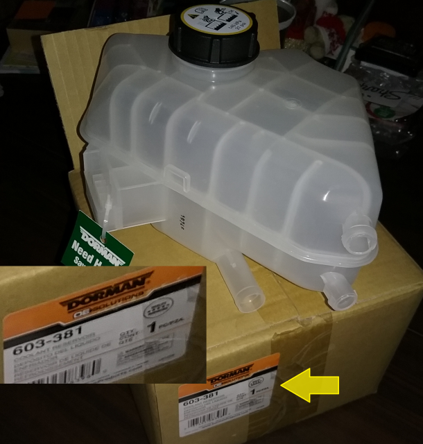

When I changed my coolant reservoir with the Dorman unit pictured above, I had to use the old plugs. The rubber O-rings were shot and one of the sources of the minor leak I was experiencing. I matched the rings with a set of viton rings I have and since then the 2016 SE has been great. If I hadn't replaced that coolant tank back in the spring, I would have overheated the engine sometime during one of our last three heatwaves.

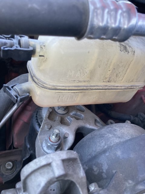

Am I ok to just fill the reservoir with coolant and call it good? In other words, does it burp itself? I filed it twice since running it. I just pop the hood every drive or two and see where it’s at and fill if needed. Right now is the first time it stayed topped off. I’m guessing all the air is out of the system.

You'd know by how it would run if you didn't use enough coolant.
Sounds like you did well!
Good Job!
